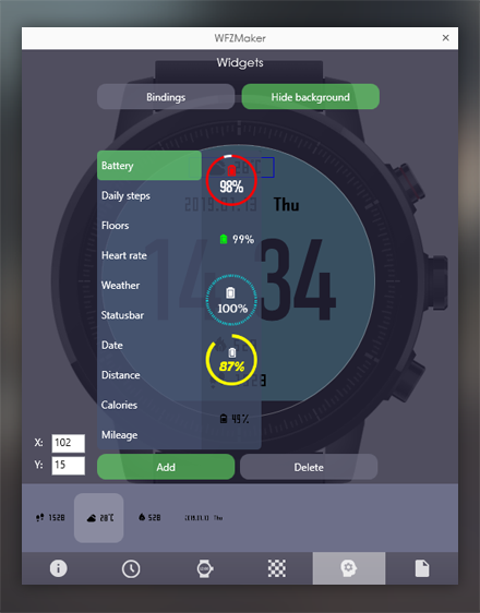

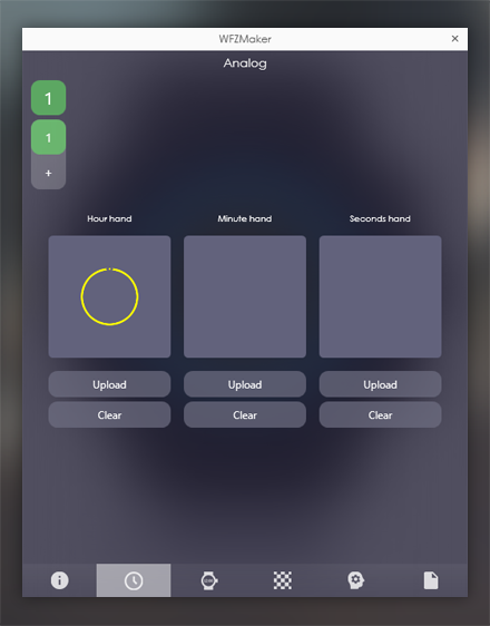

Hello :) . I present to you my program to create a watch face (.wfz). The program now is in beta.
- program only for windows ver. 7 and above,
- limit on the number of widgets in the project: 12,
- in the folder with the installed program there is a folder "Watch faces" which contains 3 unique watch faces,
- no hot keys,
- real-time changes,
- LoFi mode in real time,
- intuitive interface (i hope).
Your feedback will help make my program better ;)

- in the tab "Watchface information", field "Title" - this is how the watch face will be called in your watch, archive name can be any,
- all changes in the tab "Watchface information" automatically saved every 5 seconds, or by pressing the enter key.
How to add configuration?
- press the button "+".

- background configuration added
- timehands configuration added

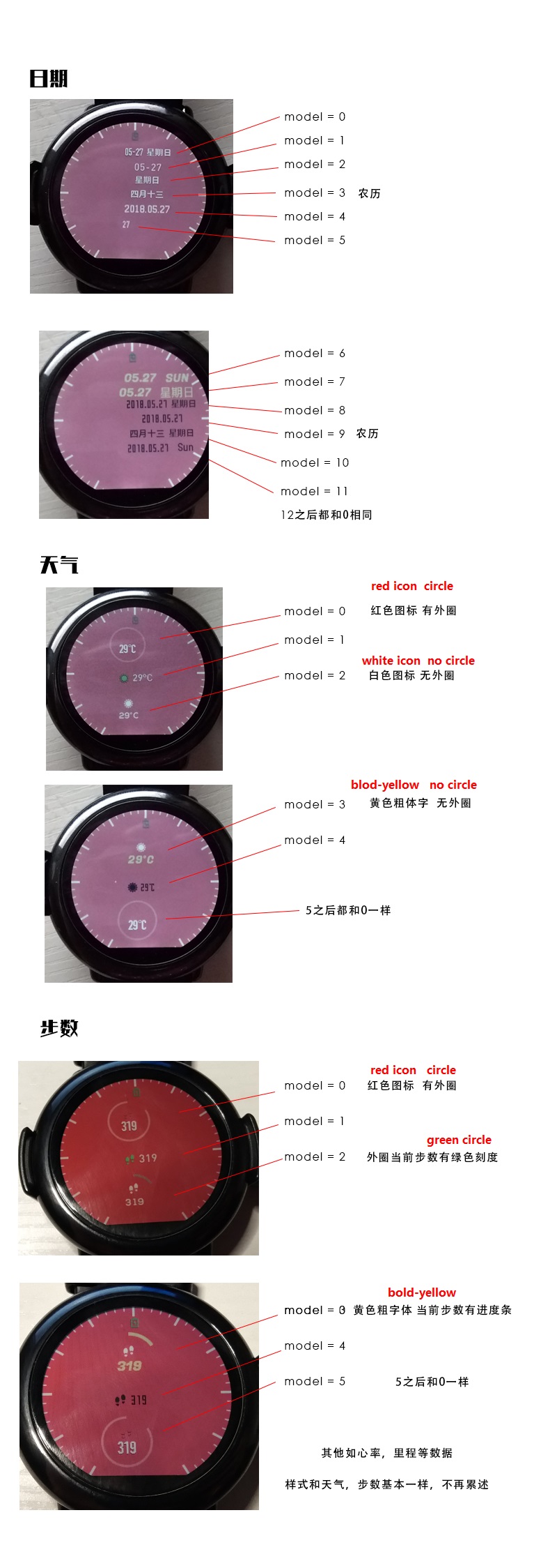

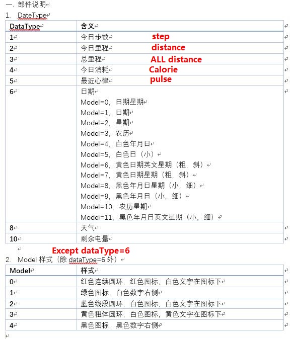

For all available patterns and parameters, please refer to the following and illustrations:
Do you know anything about creating watchface for a Amazfit Bip and Cor? I plan to add making of watchface for them.

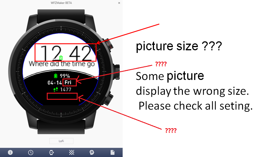

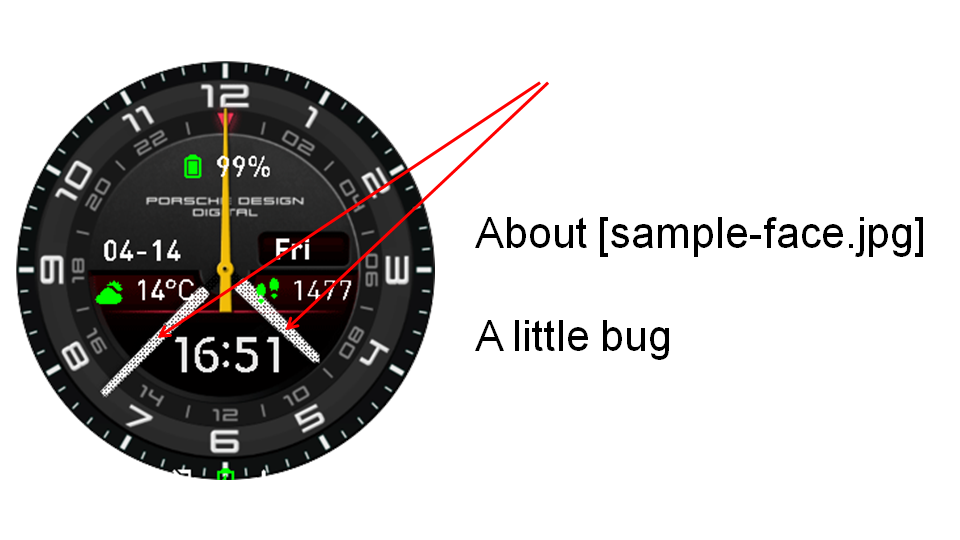

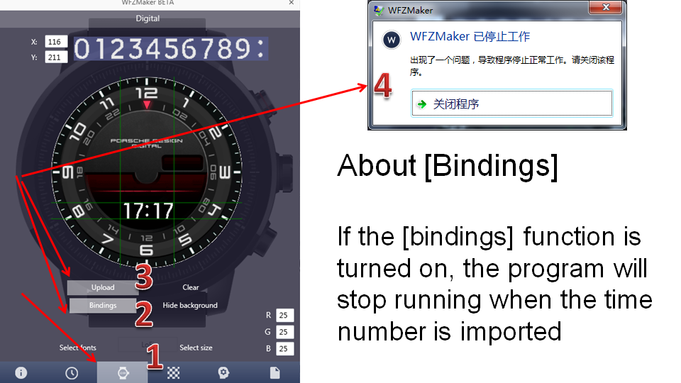

BUG feedback:

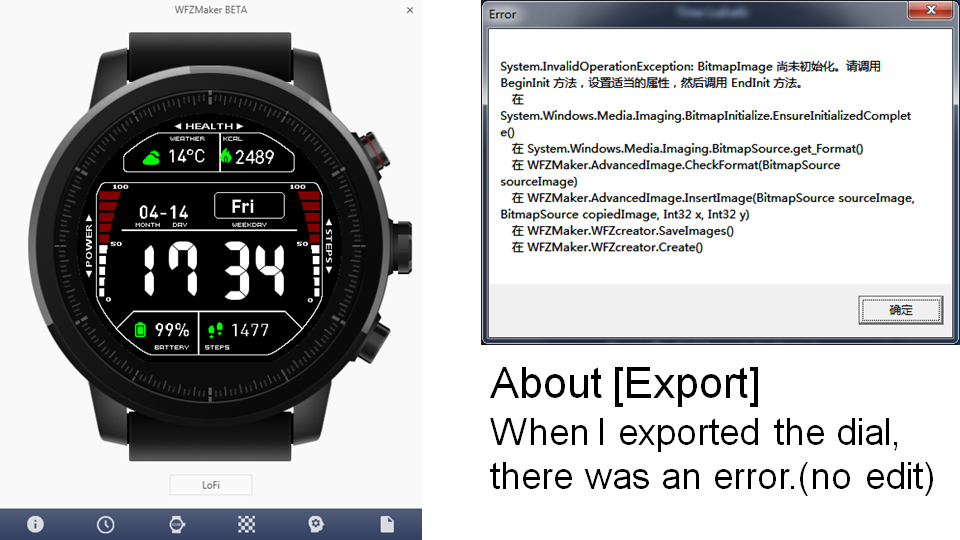

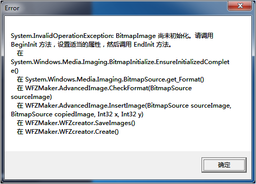

BUG feedback-2:

TXK wrote: 06 Apr 2019, 09:38
Thank! Very detailed bug feedback. Some bugs are already fixed. I will work with the rest. Verge support will be added later.
I had a problem with widgets, since the rest of the watch face builders lack most of the widgets I had to draw them manually by the screen photo. If I had screenshots with all the widgets and known coordinates, I would draw them in good quality.

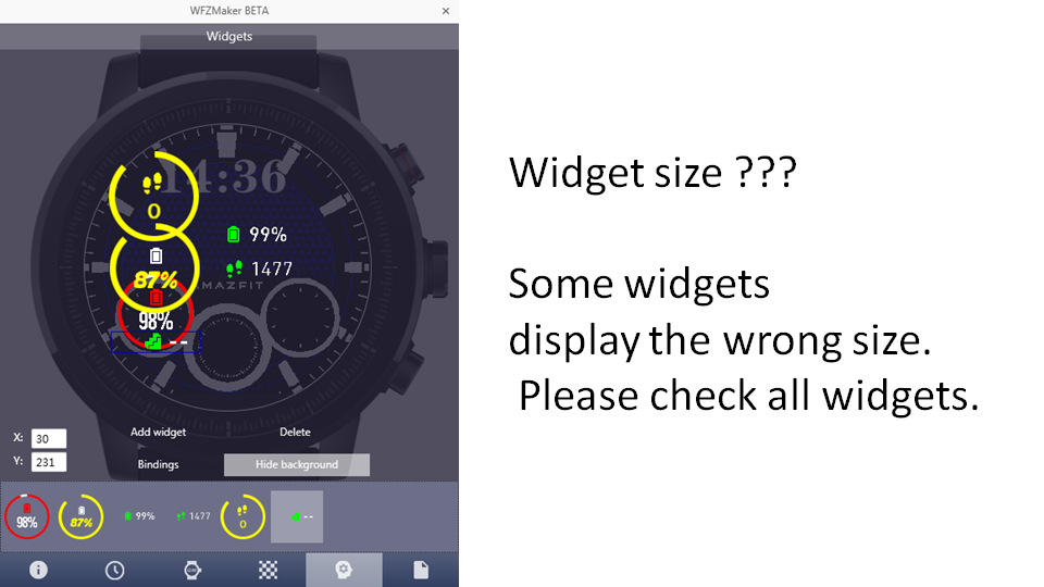

Sorry, I don't have Stratos (Pace)
:o Maybe...... I'm wrong. Yellow Widgets are bigger?)

This is the correct DPI picture. You can get the right Widgets from here
You can also use this background image to check whether the size of Widgets is normal.

On the stratos yellow widgets have size 100x100 pixels, but for example, red circle weather widget have size 84x84.

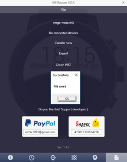

Open the following dial file and save it directly (without modifying it).
Program stop runing
verge-moto.wfz
(81.94 KiB) Downloaded 1550 times
VIzzAR
Post by VIzzAR »
TXK wrote: 09 Apr 2019, 12:39
Program stop runing
verge-moto.wfz
What version of the program? In V1.3.0 all ok.

VIzzAR wrote: 11 Apr 2019, 15:17
Program stop runing
verge-moto.wfz
It doesn't work in version 1.2.0.
1.3.0-1.4.0 can be saved
