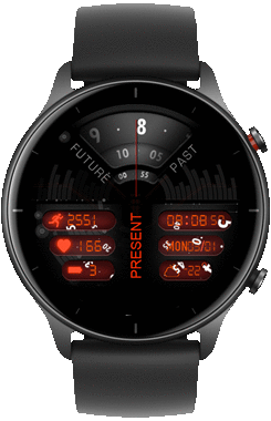

Good morning to forum, can anyone who has knowledge help me to convert this watchface for GTR2 exactly as it is. I already take permission from wax and i want thank him and of course all creators who help us a lot. Thank you and have a nice weekend.
https://amazfitwatchfaces.com/gtr/view/27073
- Posts: 2224
- Has thanked: 438 times
Based on my opinion, I think the watch face you requested. This is unlikely to be possible on the GTR2 as GTR2 is unable to switch element layers.
The key point of the dial is that "analog hands" must be at the lowest layer.
It's must be switched to the last of the layer.
But in GTR2 "analog hands" are always set to the top of the layer.
Then I think it can not do for GTR2
What can be done is what is shown in the picture.
This watch face file will be displayed as shown in the image above.
which I think is unlikely to be suitable for use.
