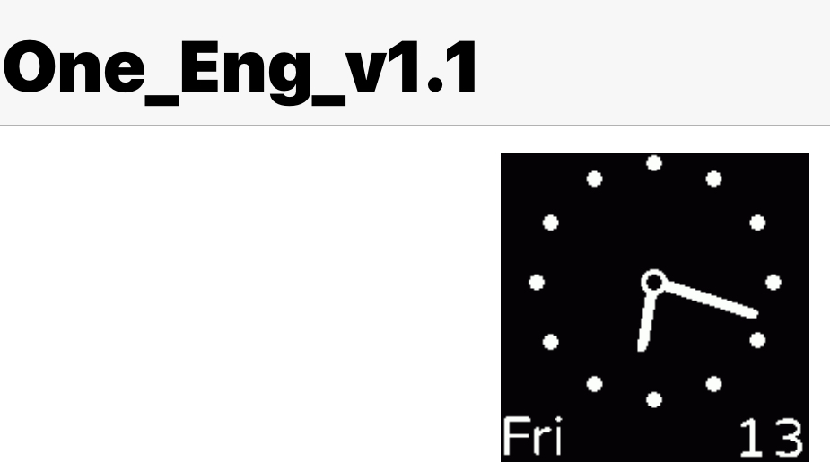

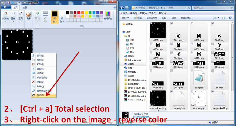

Looking for someone who would be willing to take my favorite watch face and invert the colors. It’s a simple analog design with day and date. Currently it is white over black background. I would like to have it with black hands and date/day over a white background. Too big a learning curve for me.
Thanks!

Give me your favorite dial, and I'll turn it into a white background dial for you.

The dial can be seen on the AmazTools site; apparently it is not a bin file. But the name is One_Eng_v1.1
Here is a screenshot... Thanks!

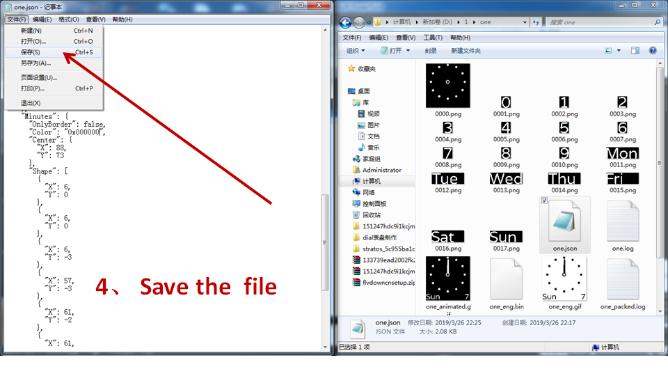

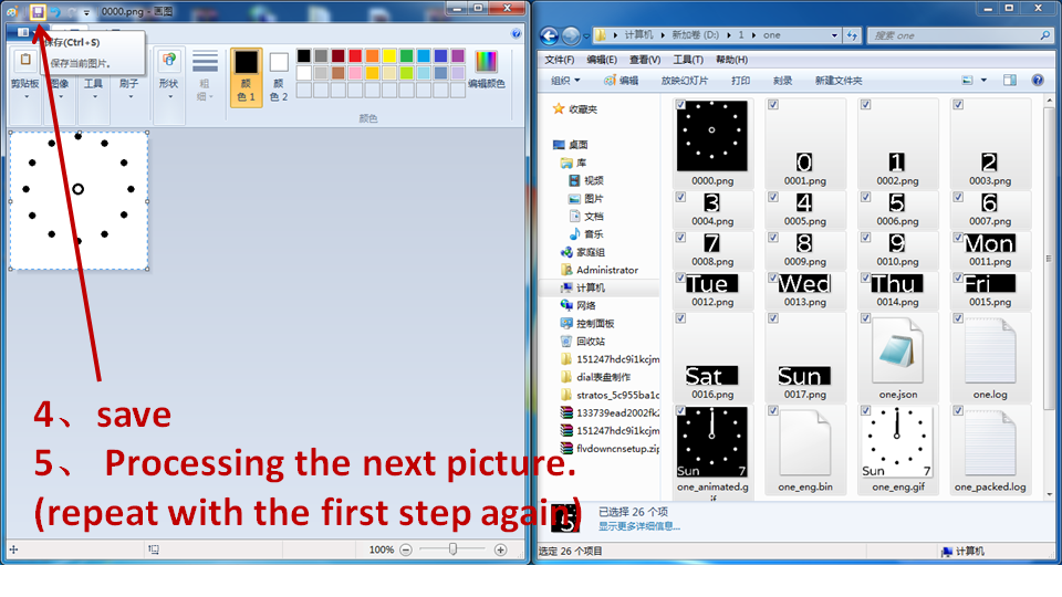

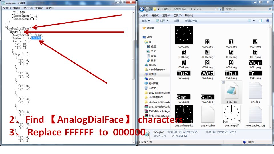

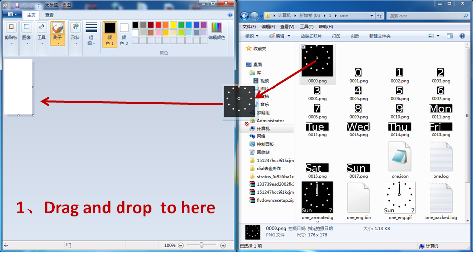

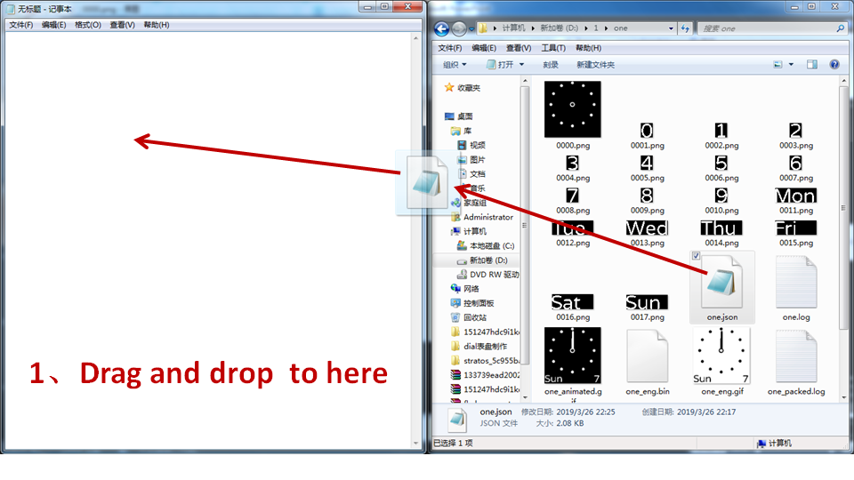

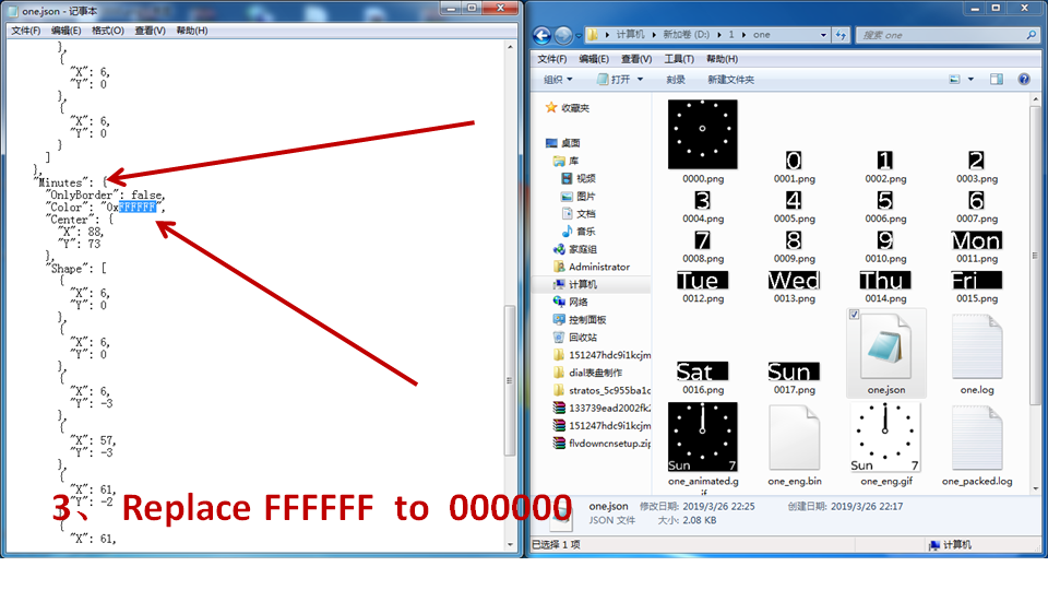

download [AmazfitBipTools]
https://bitbucket.org/valeronm/amazfitb ... downloads/
1. unpacking dial with [AmazfitBipTools]
2.Learn to modify with me:
3.packing dial with [AmazfitBipTools]
here:
one_eng.bin
(6.67 KiB) Downloaded 257 times

Tips:
1. With the above method, only the dial of a single color background image can be modified.
2. If there is a dial with transparent overlay material, this method can not be used.

Thanks a billion!! Got it installed and this will be an enormous help to me. And thanks for the tutorial; I will study it and learn how to do this.
