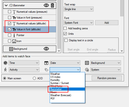

Sasha's editor can create a watch face with some of the information you mentioned.
1. Display height. But I'm not sure if Active2 supports this, as some models, such as the GTR3 and Bip6, don't support displaying height on the watch face.

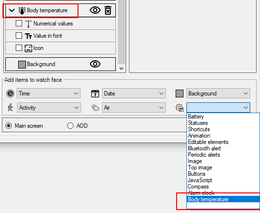

2. Temperature (of the internal sensor; not from weather). If you mean body temperature, the editor can display it as an option, but I'm not sure if Active2 supports it.

Sensor temperature and altitude was possible - message (count) not.
