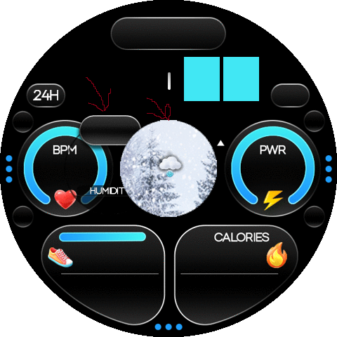

Hi, Could you please show me how to overlay the icon on top of the weather image? Check out the picture below; your work, and I’d appreciate any guidance you can offer, as this isn’t the first time I’ve faced this issue. The top image might work, but do I need to place the temperature icon directly on top? GTR3 Pro - Thanks, friend!"

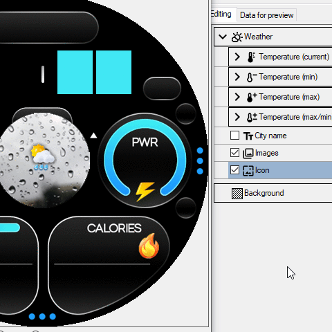

I'm not sure if you created a new dial or converted from my Balance. If you converted from my work, you shouldn't have this problem.rush2112 wrote: 26 Apr 2025, 19:34@asoo
Hi, Could you please show me how to overlay the icon on top of the weather image? Check out the picture below; your work, and I’d appreciate any guidance you can offer, as this isn’t the first time I’ve faced this issue. The top image might work, but do I need to place the temperature icon directly on top? GTR3 Pro - Thanks, friend!"Spoiler
However, if you created a new dial with the image you received after unpacking, I recommend sending the file so I can advise you correctly, because I don't know how you arranged the layers of the elements.
However, my watchface arrange the layers like this,

From what you've sent, you make it correct, but I expected you are not know that some sub elements it can moved layer position moved, same as a main element, by left clicking and holding the mouse and move to changing the layer position of that sub element.rush2112 wrote: 26 Apr 2025, 21:38@asoo
If you have a moment, could you please review what I did wrong?
I tried to install yours, but it's not displaying the time and weather. It's strange.
Sample : move layer in sub element
As for the time display, I'm not sure what part you mean.
Because in the attached file I don't see the time part.
I guess you mean that Seconds Analog pro doesn't change color according to the screen.
If used in this part, the problem is that when I finished packing,
I inserted my own custom script in index.js.
By inserting it in the "switch background" section
In this section you can see in the index.js in my watchface.
if (toastText.length > 0) hmUI.showToast({text: toastText});
normal_background_bg_img.setProperty(hmUI.prop.SRC, backgroundList[backgroundIndex]);
normal_analog_clock_pro_second_pointer_img.setProperty(hmUI.prop.SRC, "Hand_S" + parseInt(backgroundIndex + 1) + ".png"); // The part I inserted
};Code: Select all
if (screenType == hmSetting.screen_type.WATCHFACE && normal_background_bg_img) {
})I recommend you convert my watchface and study more from index.js which is converted and you should understand it better.
