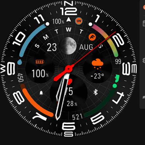

Hey,
I recently found out this amazing Galaxy Watch Ultra watchface for Balance,
Is there possibility to port it for GTR 3?
Here is link for it https://amazfitwatchfaces.com/balance/view/1238
Thanks in advance :)

SPLESHER wrote: 23 Aug 2024, 09:34
Hey,
I think it can't work properly on GTR3
Because GTR3 can't show compass on watchface
But if you don't want compass part you can convert to GTR3

SPLESHER wrote: 23 Aug 2024, 13:25
I was thinking that compass wouldn't work at all, but I'm totally okay with that
Watchface looks still very good without compass function working
GalaxyColor_GTR_3.zip
(674.08 KiB) Downloaded 53 times
Note :
UV and humidity will only show horizontal numbers because it is a limitation of GTR3.

Wooow, that looks great, I was just wondering, if it's maybe possible to add digital time instead of e.g. moon phases? I'd do that, but I'm not that great in editing watchfaces sadly :/

I understand, best to do it would be probably in sasha's editor right?
Posts: 2120
Has thanked: 409 times
Been thanked: 2037 times
That's right, you can further edit the basic elements
using sasha's editor, but in the part that uses, should control the changes of the screen elements, you have to manage using custom scripts, in this part you need to have basic knowledge of javascript programming, but the script will not be displayed process in the editor, but it will be included in the script's element in the editor.
If you want to test the operation of the watch face that uses custom scripts, you need to use the simulator to test and verify the correctness of the watch face.
The simulator of the device that uses ZeppOS 1.0 as the operating system
https://mmk.pw/zepp_player/
Have fun customizing your watch face to suit your own style, all by yourself.

Thank you, I will try messing with it, btw. if it's not mystery, you use tool for porting these watchfaces or just manual javascript or anything? I tried converting bunch of watchfaces via Sasha's editor, but they don't have e.g. switchable theme

I'll answer as I understand it. Porting the watchface consists of
1. The image you want to use. In this part, I use the graphice editor program to perform the operation, trim, edit the image to use in creating the dial.
2. In the part of creating the basic structure of the dial from the image processed from point 1, I use Sasha's editor to do it.
3. In the part of adding additional tricks from the standard script created from Sasha's editor, I use javascript (because zeppOS is based on javascript).
So I don't think it's a mystery. If you have basic knowledge in graphic editor, javascript, anyone can definitely do it.
I hope that this answer is complete.
