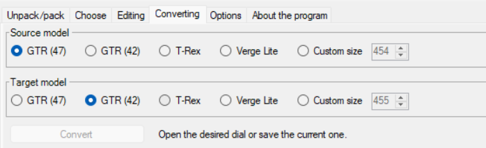

Hi asoo, thank you for this watch face.
Can I convert other wf's with Sasha tool? Which options should I choose?
- Posts: 2226
- Has thanked: 441 times
From the picture you attached, it's Sasha's editor for
GTR1 and version 1 of Device Amazfit only.
It cannot be converted to GTR 4 which is 3rd generation and higher of Amazfit Device which uses ZeppOS.
According to the link you mentioned earlier.
Cannot be converted to GTR4.
Because the dial in that link is the dial that is on Operating system Others that do not use zeppOS (the GTR4 use ).
The only thing you can do is unpack the watch faces from those links.
and resize the images to fit GTR4 and recreate them all with "Sasha's Editor" for the ZeppOS system.
That is why I chose to make only one watch face for you.
Because conversion is not possible. If you want to use it with ZeppOS, you have to create a new one from the original resource image only, which would take a lot of time to do, and I think i will not do that, for the reasons already stated.
