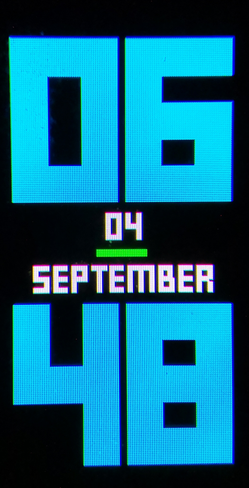

Maybe I found a bug
I have the problem, that in one of my watchfaces i recognize a difference of the battery icon positions between preview and live picture on the band. I think 2 pixels to the left on the band.
Battery icon is the colored dash in the middle.
Numbers have all the same size.
"Status": {
"Battery": {
"BatteryConfig": {
"BoxWidth": 0,
"Alignment": 0,
"Order": 0
"Icon": {
"X": 46,
"Y": 122,
"ImageIndex": 31,
"ImagesCount": 9
The attachments show what I mean.
Maybe an error on my side?
Please take a look!
preview generated with MiBandWFTool
Image took with my smartphone
unnamedbig_blue_german_packed.bin
the bin
(26.58 KiB) Downloaded 211 times
lvpokka
Posts: 178
Joined: 07 Jul 2019, 20:22
Location: L1
Has thanked: 19 times
Been thanked: 152 times
Post by lvpokka »
hyippiemon wrote: 04 Sep 2019, 05:13
As i see there is shift for 1 px for Date and 1 px shift for battery... didn't saw this previously) maybe it's some miscalculations in alignments.Not critical, probably will shift back in next release.
Thx
hyippiemon
Posts: 6
Joined: 16 Aug 2019, 04:05
Post by hyippiemon »
thanks, yes, seems to be an alignment (Center) issue
took "Left" now -> no difference between preview and live picture
