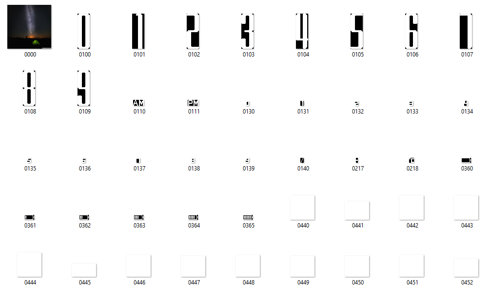

Disassemble .bin file with AmazfitBipTools, click on Select images and select them from watchface folder by Ctrl+A, then select JSON file by clicking on JSON Select. After that you can set numbers to display by clicking Settings or edit the watchface

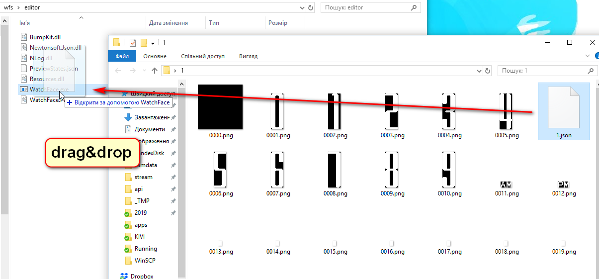

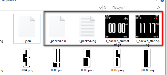

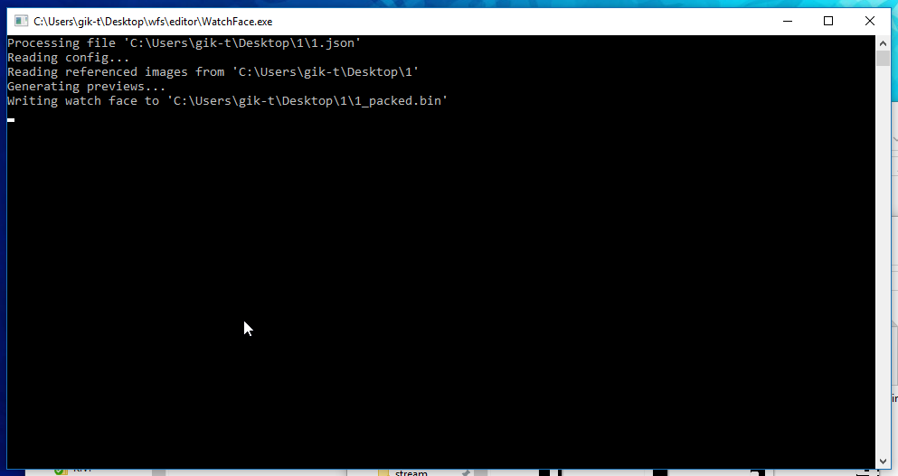

Put all your pngs and json in one folder, then drag&drop your json directly to Watchface.exe
screenshots
To unpack .bin drag&drop it directly to Watchface.exe

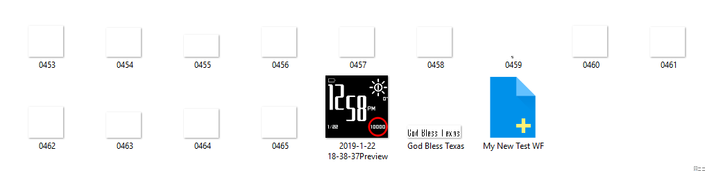

I've already tried running the final json file back through watchface.exe, but when it populates the new folder with the new pngs and json file, it does not have a bin file located in it. It only has a text document in the list. I can't figure out how to turn everything back into a bin file.
technoloZEN
Posts: 13
Joined: 14 Jan 2019, 17:58
Post by technoloZEN »
I keep getting this text document message when I try to send the new json file back through watchface.exe
Posts: 1033
Joined: 22 Mar 2018, 10:00
Has thanked: 1181 times
Been thanked: 281 times

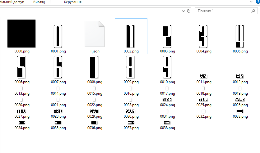

Post by GIK-Team »
You do not have all the pngs in the folder. 0000.png, 000.png, 00.png, 0.png doesn't exist.
technoloZEN
Posts: 13
I don't even see any of those pngs in the folder, other than the 0000 pic, which is my background image. After I created the new json file from the WF Editor and ran it through the watchface.exe, this is everything it populated in the new folder (see below).
