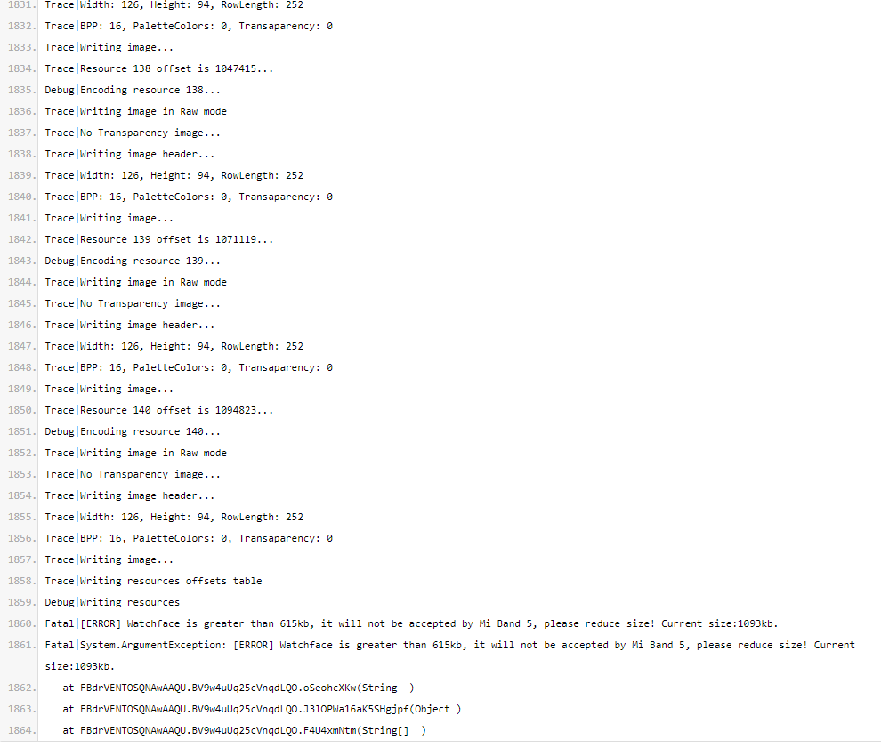

I finished making my watch face with this tool, but when I want to compile it it says it is greater than 615kb, it says it is 1093 kb, but in reality is just 511kb, the problem seems to be a gif included in the watchface (it has 30 frames) and when I set it to 10, it can compile it, I'm not really sure why though, here's the log error part, I can't include the pastebin link :/
Adjuntos
