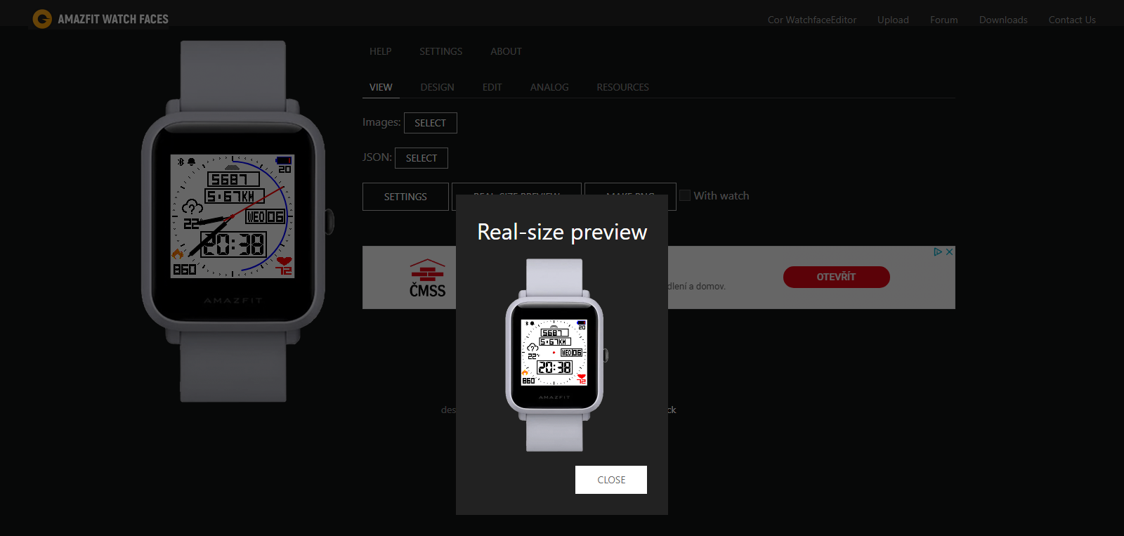

Hi I have similar problem but with all hands/pointers :
I tried to modify one WF to my language and it works. But then I tried to add also seconds pointer. Everything works when I check it in settning. When I try to look at Real-size preview, all pointers are gone. Why? Everythig seems to be ok in json file.
I also tried to open existing WF downloaded here ond open it in WF editor. It behaves the same (bad) way. No pointer is in Real-size preview.
Do you know where could be a problem?
Thank you
Petr

PetrZ wrote: 16 Mar 2019, 11:48
Thank you
Petr
Real-size preview IS NOT Real-size pre【view 】
Real-size preview is ONLY [Real-size]
