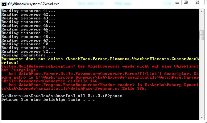

I have now tried to extract a bin file using the tool viewtopic.php?f=29&t=816&p=2313#p2313 offered here. I don't use original Watchfaces but custom Watchfaces already created by users like https://amazfitwatchfaces.com/gtr/view/2081. Unfortunately the error is always the same as shown in the picture. Can anyone help me with this?

That is the problem. I used python 3.8, newer than the specified one. But nothing happens...
Volker Liebzeit
- Posts: 4
- Joined: 27 Dec 2019, 12:43
- Location: Germany
IThanks for your help, I have also tried several programs. The problem always occurs when I want to unpack Watchfaces with weather. The post says you need Python+pillow. This Pillow is the problem I think. I tried to install it but somehow it doesn't seem to work.
The yellow bar in my posted picture shows that there is a problem with the weather icons.
Well, then I just have to wait for you to put beautiful Watchfaces online again

Setup Python Tool environmentVolker Liebzeit wrote: 01 Jan 2020, 05:29IThanks for your help, I have also tried several programs. The problem always occurs when I want to unpack Watchfaces with weather. The post says you need Python+pillow. This Pillow is the problem I think. I tried to install it but somehow it doesn't seem to work.
Well, then I just have to wait for you to put beautiful Watchfaces online again![]()
viewtopic.php?f=38&t=1110
With SashaCX75Tool Gui, in 5.1 you can't unpack with the "No Python Tool Version of this Gui Package, retrieved @4PDA on Sascha75 link ] When you try, It does nothing on Hikashi Watchface [ The One with Analogic Extra Hand or on my Daytona ]
Got a private messaging discussion for this problem with MaikelDevil and create The Setup Python Tool Post available here
When Python + Pillow is done, go to https://github.com/amazfitbip/py_amazfit_tools/branches
And retrieve the Fix Array branch [ More option than Loly Python tool to design ]
My Link to a zip file that has
SashaCX75 Gui Tool 5.1 Python Version
SashaCX75Gui Tool No Python Version
fix_array by dpeddi Python Tool :
https://drive.google.com/open?id=16JxHh ... w4sSZ3P3N1
Don't forget to Thank Dpeddi and SashaCX75 on 4PDA if you can^^
