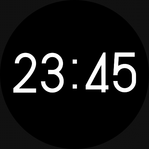

Is it possible for T-Rex 3, that as I touch a specific part of the screen it switches in between showing the digital time and on a nother touch it shows the date and day? Unfortunately I couldn't do this yet. Can anyone help, please? :)

This can be done on T-Rex3, you need to write a custom script to handle the parts you want.
This is an example watchface that switches the time and date by clicking on the screen.
Time_Date_Trex3.zip
(97.15 KiB) Downloaded 63 times
You can unpack this watchface file using program "Watch Face Editor for Amazfit watches on ZeppOS."
For see the custom script and editing,

If you want to add a custom script, you must add it to index.js. you can find "index.js" in the watch face .zip file.
The .json file you mentioned is likely just a script that the editor provides to store details for creating the watch face. You won't find custom scripts in .json.
