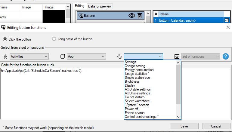

For Buttons its a good way to use functions like:
"hmApp.startApp({url: 'WorldClockScreen'...
Where can I find all this URLs or other apps, do you know a list or a address, I can't find here or on
https://docs.zepp.com/docs .

If I remember correctly, to view "application page names,"
you have to search for them in the firmware, and not all will work; it depends on the device and other things. However, as far as I know, newer firmware versions are encrypted, making them impossible to search for "application page names."
You can download the firmware at this link:
https://mmk.pw/en/zepp_explorer/firmwares/
However, there's another way to find working "application page names." You can try looking at SashaCX75's "Watch Face Editor for Amazfit Watch on ZeppOS."
He's compiled some of the "application page names" that are readily available in the Function Button section.
Hopefully this information will be useful to you.

Thanks. I found in the firmware-zip a lot of functions in \META\resources\offlineasr\offlineASR.json behind "Category"for my Active 2 round.
