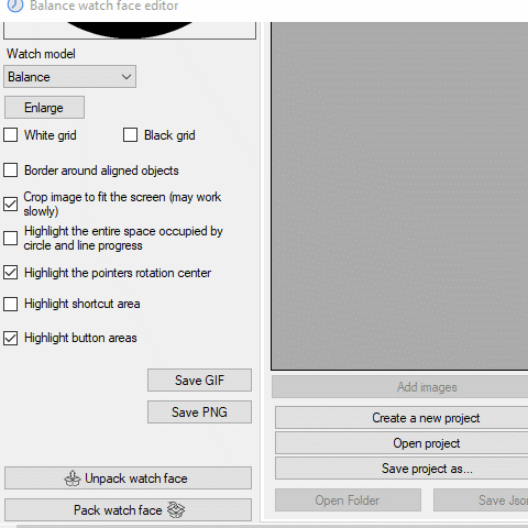

You can unpack the watch face file using the "Watch Face Editor for Amazfit Watch on ZeppOS V14.1.1" program. You don't need to convert the image. The program will convert image immediately when you unpack it.
Click here to see unpack location on program 🖼️
The program will also read the watch face's index.js file and create a .json file in the program's own format (the app.json file is not the watch face's script file). However, the watch face must be an unencrypted watch face, and the watch face's index.js format must be in a format the program can understand. Otherwise, the unpacking will only yield a standard PNG image.

I was so far with Device.zip file, but where ist this "Unpack" on "Watch Face Editor for Amazfit Watch on ZeppOS V14.1.1" ?
Posts: 2147
Has thanked: 414 times
Been thanked: 2073 times
marrud12 wrote: 14 Aug 2025, 09:46
I already answered this question in a previous thread.
I also provided a picture of the unpacking process in that thread.
You can see where the unpack button is located by looking at the picture in that post.
Click on the link to return to the previous post.:
viewtopic.php?p=20988#p20988
Please see the image by clicking on the image icon.

Sorry I did'nt see the Video... It works and I also managed it by open with command line.
