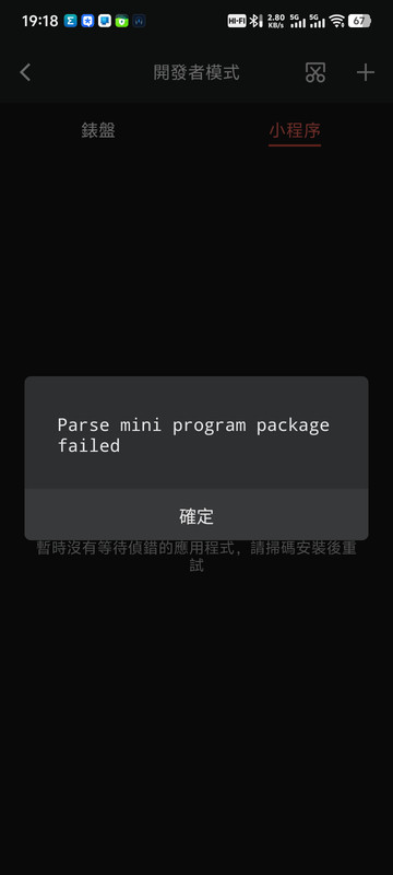

The QR code installation in the original watch face link will display the following error
The QR code you provided can be successfully installed in Balance2
The error image you sent can happen when you don't refresh your browser before generating the QR code or you generate the QR code and you don't use it immediately, until it exceeds the specified time. It will cause the problem as you reported. Therefore, it is recommended to generate it before installing. Don't generate it and leave it.
