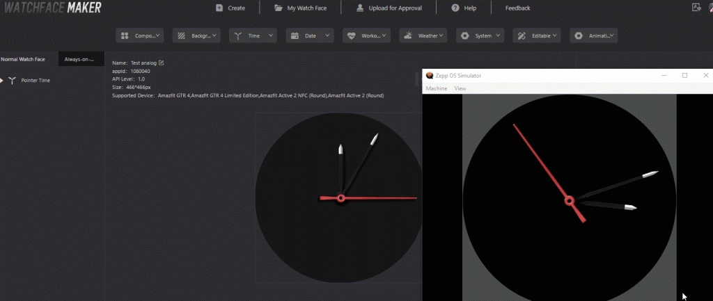

I've tried to create a basic watch face with "watchface maker"
Amazfit Active 2. And tested with simulator and "Balance" , "bip6"
Because I don't have Amazfit Active 2, so i cannot test on Active 2 But all device that I test it use zeppOS nearby or same Version with Active 2.
From testing the watch hands, they can work properly.
I use the basic configuration from the guides sent earlier.
So I'm not sure what the problem is you're having. I guess it's due to some incorrect settings or it's possible that Amazfit Active 2 has a problem. But I'm not think if the problem is caused by Amazfit Active 2 because other devices using the same ZeppOS Version and simulator work without any problems.
Image from the test
