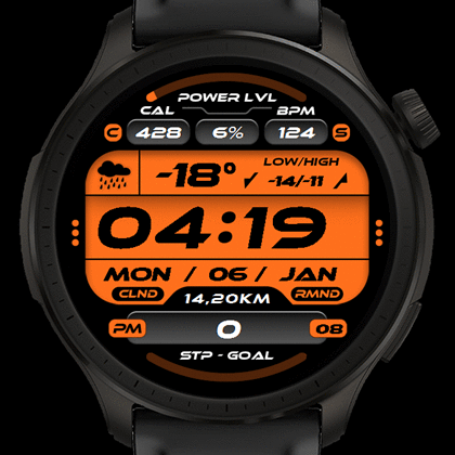

Hello, guys! Can someone port this watchface for balance with ability to change colour like original. Thank you.

I've changed it a little, hope that's okay.
Or do you have any other suggestions?
If that works, I'll continue, all that's missing is AOD and the color change. UPDATE
WF is ready, I just can't find the script for the 24h icon anymore.
Publication then shortly

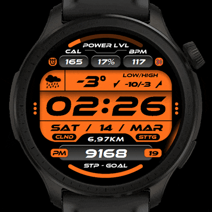

New problem: WF is ready, see attachment. but.....
My watch does not recognize the .tff and unfortunately does not display any values.
You can test it yourself.
Unfortunately, I don't have the time or inclination to create all the fonts using an image.
Maybe someone else will take pity on me

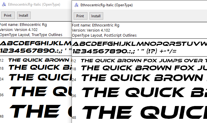

The font is not displayed because the font used is not TTF.
Most fonts obtained from facer are OTF. Although the editor can display it correctly, it may not be displayed on the clock.
Therefore, if you want to use a font, make sure it is TTF or, if it is OTF, convert it to TTF before using it.
Example convert online
https://cloudconvert.com/otf-to-ttf

fixed ( convert OFT to TTF)
Test on My Amazfit Balance work normal
Fixed X,Y 24H icon : viewtopic.php?p=20226#p20226

Quick question: how can I tell whether the .ttf needs to be converted?
I have downloaded this font as .ttf and not as .otf

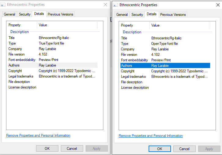

The easiest way is you can check it is otf or ttf by use the windows font viewer that is built into windows.Lattenknaller wrote: 01 Apr 2025, 09:06Thank you for that.
Or you can right click on the font file and view the file properties.
