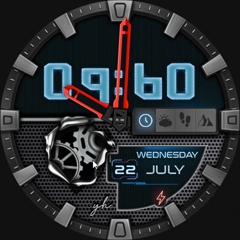

i use zepplayer To view the watch face and try it, but I cannot find the balance simulator, and even when I use the gtr3pro emulator, it does not appear as it actually is.

I think it's hard to answer your question.
If possible, you should attach the file you used to test.
From the image you provided, I guess you not have a script that hides each element, so when you test, all elements are displayed at the same time.
Also, when you click on the icons to try to change the element, it seems like those icons are shortcuts to the data of each element, not buttons that change the group of elements you have defined.
However, this is just a guess, because there is only a picture to use to decide on to the question you asked.
In the ZeppPlayer section, it can only emulate some of the command sets available in ZeppOS1.0 and some 2.x, so there is no balance in the list. However, if the watch face you created does not use a command set ืnot higher than 1.0, it can work normally.
I actually suggest that you ask in your original thread that mentioned this dial for continuity in troubleshooting the issue.
viewtopic.php?p=18849#p18849
I'm not sure if you saw the file I edited as an example in your old post. This is the result of the file that edited the script to work as it should.
You can find the file in your old post.
