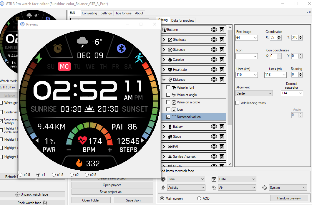

Hello guys and have a nice weekend. Can please someone with knowledge help me to port this watchface for GTR3 Pro because i try to convert it with sasha editor and whatever I do after the conversion loses quality especially on weekdays section. Αnd with argb activated it still loses its original quality especially in weekdays. Transparency is lost on the remaining days as it is in the original watchface. I try to install it without conversion in my gtr3 pro but it needs correction because shows the distance indication more to the right direction than it should. Thank you.

Enabling ARGB does not help you get the image quality after "unpack".
ARGB helps to keep quality the original image after "pack" to have the highest quality.
So whether you enable ARGB or not, The unpacking process does not improve the image quality in any way.
The image you get will depend on the image that was first packed. If ARGB was used in the "pack", when you unpack, the image will be close to the original quality.
But if ARGB was not enabled in the pack, when you "unpack", the image will be of reduced quality.
So in this case, if you want all the original quality images, it is recommended to contact the dial owner to request the original image file before packing.
But in the week day section, you can do some basic editing by increasing the color intensity with Graphic edit.
This is the week day image file that has increased the light intensity (not watchface).
You can unpack the dial, then replace these files with the original file and pack it again.
WeekDayimg.rar
(51.5 KiB) Downloaded 81 times
In the Distance section, if you can unpack it, I think you can easily edit the X Y position. You can see from the example image.

Thank you very much for the help, asoo. I don't know why but only days of the week are affected by the conversion too much, the other elements are fine.

The problem with the "days of the week" image is that some of it uses the transparency feature. As you may know, converting a ZeppOS PNG image back to a regular PNG will result in some loss of quality, especially if the image uses the transparency feature. The transparency becomes more transparent, which causes the transparency of the text in the image to become more transparent, which may cause the text to become invisible.
