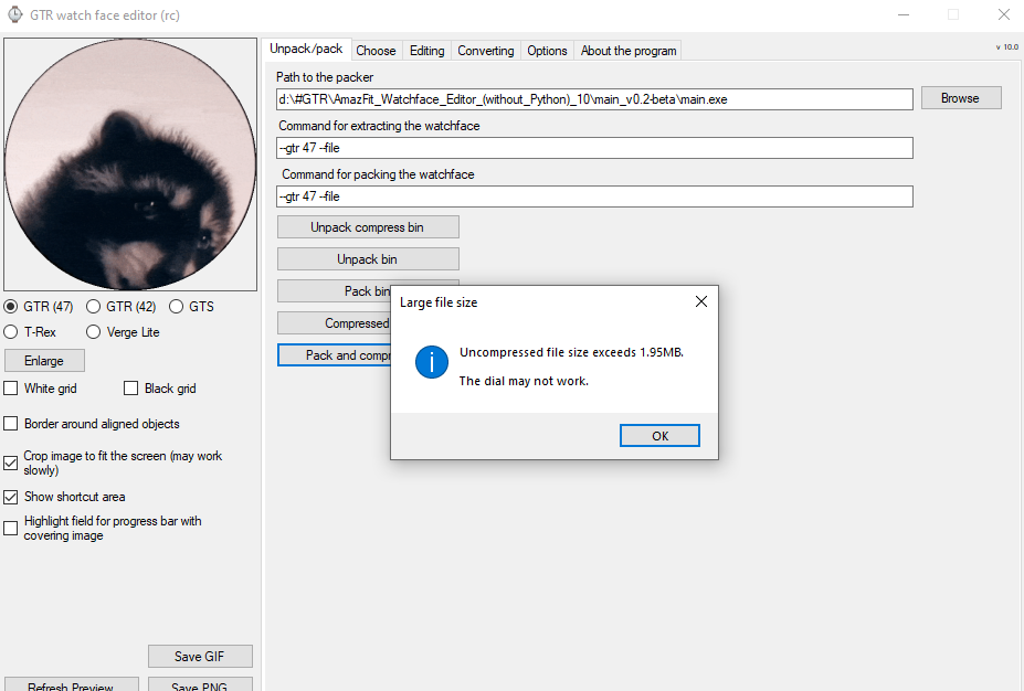

I think it can't be done.
Because if I'm not mistaken, GTR47m has a limit on the size of .BIN before compression at 1.94M. If the file size is larger than this, it may cause the watchface to be unable to sync or it may cause the GTR47m to cause a loop boot.
The animation file size that you want to display if using all images (107 images) At a size of 454x454, the BIN file before compression will be the over size , It exceeds the limit for the GTR47m to function.
Made one for the gts4. Unfortunately I can't convert it for your watch
