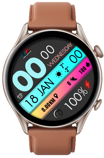

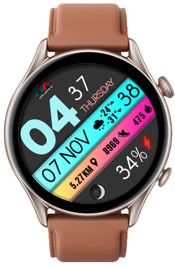

Hello guys and have a nice week. Can someone port this watchface for GTR3 Pro as it is with ability to change colours at panels. Thank you.

Thank you but watchface has some problems. Steps count shows 8000 steps always. Is it possible to remove the current temperature and put the upper and lower temperature in a angle? I think the gtr3 pro supports higher and lower temps in an angle. Otherwise if it can't take off current temperature completely and put the weather icon in the middle.
Sorry About "steps" issue now it fixed and change center temperature to MAX / MIN
Please download again :

Thank you so much, asoo for weather min and max temperature. Now it's perfect, steps works. Have a nice day.

How can the arrows for the upper and lower temperatures be added with Sasha's editor?
It cannot be done directly in the editor.
ฺBut you can do it in 2 ways.
1. Just edit by add icon in all 11 main images.
2. Add an image icon to the assets folder and add a script to display that image.
You may use a function "icon" in any appropriate element.
In this case, I use Method 2, using function "icon" in the moon element to perform the operation.
You can dowload Version 2.01 in the original Download topic.
viewtopic.php?p=17738#p17738
If you want to edit anything further than this, please do it yourself.
