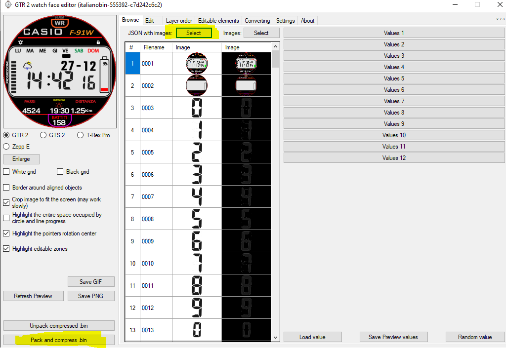

For GTR 2e how can I get the bin file starting from the joson file? I attach the file
Per GTR 2e come posso ottenere il file bin partendo da file joson ? allego file

Do you mean you want to pack the watch faces from the resource you attached?
If yes, you can use "AmazFit WatchFace editor 2 for Windows" program. " to make it
viewtopic.php?p=8392#p8392

Thank you for the quick response. I have done what you tell me several times but the program does not generate the bin file. Maybe windows smartscreen or something else, prevents writing to disk c????
Ti ringrazio per la rapida risposta. Ho fatto quanto mi dici più volte ma il programma non genera il file bin. Forse windows smartscreen o altro , impedisce la scrittura su disco c ????

If you pack and don't receive "bin", it may be because there was an error in your resource. In this case, you can view the error in " .log".
I have checked and your problem is:
italianobin-555392-c7d242c6c2_packed.log
2024-03-05 22:31:21,244 - root - DEBUG - File D:\#GTR2\AmazFit_Watchface_Editor_2\Watch_face\temp\italianobin-555392-c7d242c6c2\0211.png doesn't exist.
2024-03-05 22:31:21,244 - root - DEBUG - File D:\#GTR2\AmazFit_Watchface_Editor_2\Watch_face\temp\italianobin-555392-c7d242c6c2\211.png doesn't exist.
It looks like the file named it wrong. This causes the order of merging packs to have problems.
The solution in this case is Rename the file 02011.png to 0211.png.
I have tried editing and packing and was able to fix the problems you reported without any problems.
italianobin-555392-c7d242c6c2_packed.bin
(510 KiB) Downloaded 70 times
However, I haven't tested it on a real device. Since I don't have a GTR2e, if you want more accuracy. Please double check by yourself. for accuracy
