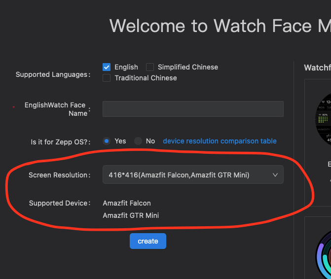

The standard editor from Huami works with this watch model without problems.

GTR Mini is the same as Falcon. They have the same screen resolutions. ;)

Yes, both have the same screen resolution, but the png structure of GTR mini has changed in new format, maybe difference color mapping, have to wait until @SashaCX75 make a new image convertor for it.
this post is clearly proved that the png structure has changed.
viewtopic.php?t=3461
This does not negate the fact that in the Watch Face Maker from Huami, these watch models are combined into one item:
