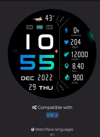

I am having problem with my PM and AM for this face watch last time asoo Did fix the issue for the color blue and now I am doing the color Orange but the AM and PM it's not showing on my smartwatch ( it's showing okay on the image but when you install on
the watch can't see nothing.....can someone help me please :)

I don't have GTR2 so I can not test your watchface on real device.
but as I can see You didn't edit component the main screen image to look like the watchface blue one, you still use the image from the GTR3, that might cause the problems you mentioned.
however I can't come to any conclusions for sure because I don't have a GTR2.
