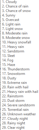

icon weather T-rex has only 26 images and may be arranged unlike T-Rex2.
Therefore, after obtaining images from converting in item 2, check for correctness and increase the number of icons to complete 29 icons according to the requirements of T-rex2 before use (details of icon arrangement can be found in editor)
Weather list :
