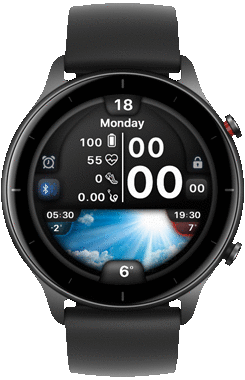

Good morning to community. I was always looking for a watchface with such a different and unique weather icons from the other watchfaces and I believe i find it to this vertical 2 watchface. Can anyone help me to convert this watchface for GTR2 exactly as it is, i prefer v2 version. Thank you for support and to Paulpsp80 for the amazing watchfaces. He say that everyone can convert but with provide a link to the original. https://amazfitwatchfaces.com/gtr/view/27601

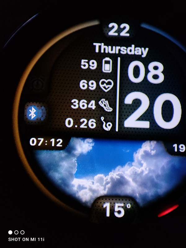

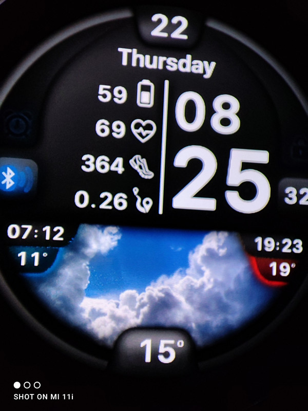

I'm sorry but can you fix current temperature isn't in the middle. The date is in the middle as you can see. I attach images to see the difference.
Your watchface is like this
Must put little left than it is like this
Thank you.

I can see the difference in your picture but I can not test on real device because I don't have it so
Therefore, I have already stated that If the field is invalid Interfere with those who have the device to check and fix it themselves.
I think , this is the last time I'm going to fix it . and maybe i will stop to port any device that I no have it.
However, I'm also not sure if it will display correctly.
Because I don't have this device for test.
I have modified according to the value of the watchface you attached the image.

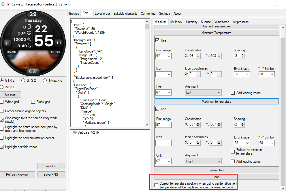

  From this
        "Type": "Weather",
        "Digits": [
            "CombingMode": "Single",
            "Digit": {
              "Image": {
                "X": 175,
Change to this
   "Type": "Weather",
        "Digits": [
            "Digit": {
              "Image": {
              "X": 173,
If you still don't like.
Yo can unpack watchface and edit "watchface_name.json" by use notepad or other text editor.
You can modify the value of "X" less to move it to the left.
This modified according to the value of the watchface you attached the image by change X to 173 .
viewtopic.php?p=13781#p13781

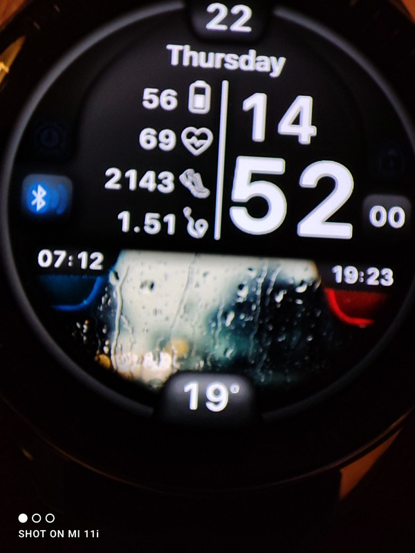

Sorry to bother you again, it won't happen again. It's fixed and it's right now. It's just in the middle as supposed to be. Now it's display correctly but low and high temperature disappear. I don't have problem if low and high temperature can't fix, you can take off completely. I attach photo. Thank you, have a nice day.

I haven't removed the low high temp, I assumed it was caused by it's probably due to disabling the funciton "correct temperture..........." so that the "center temp" can be adjusted to the x-coordinates as you want. And I guess if the function is disabled, the temp's numeric value will be under the weather icon, thus LOW HIGH temp disappears because the blue and red areas on the left and right are part of the weather icon.
which if enabled it can't be change center temp coordinate . And the result will be like the first I did,
"Center temp" is not centered according to the coordinates. It is centered on average from the icon size and the layer of "low high center" temp is displayed on the icon.
