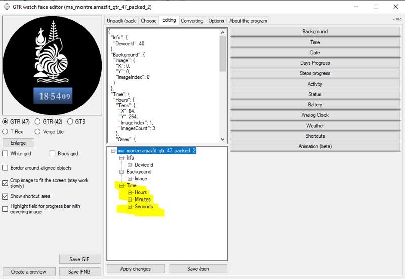

I'm not quite sure of your description.
But as far as testing through this editor, this watchface has a script that shows only digital time, no Analog, so no Analog time.
