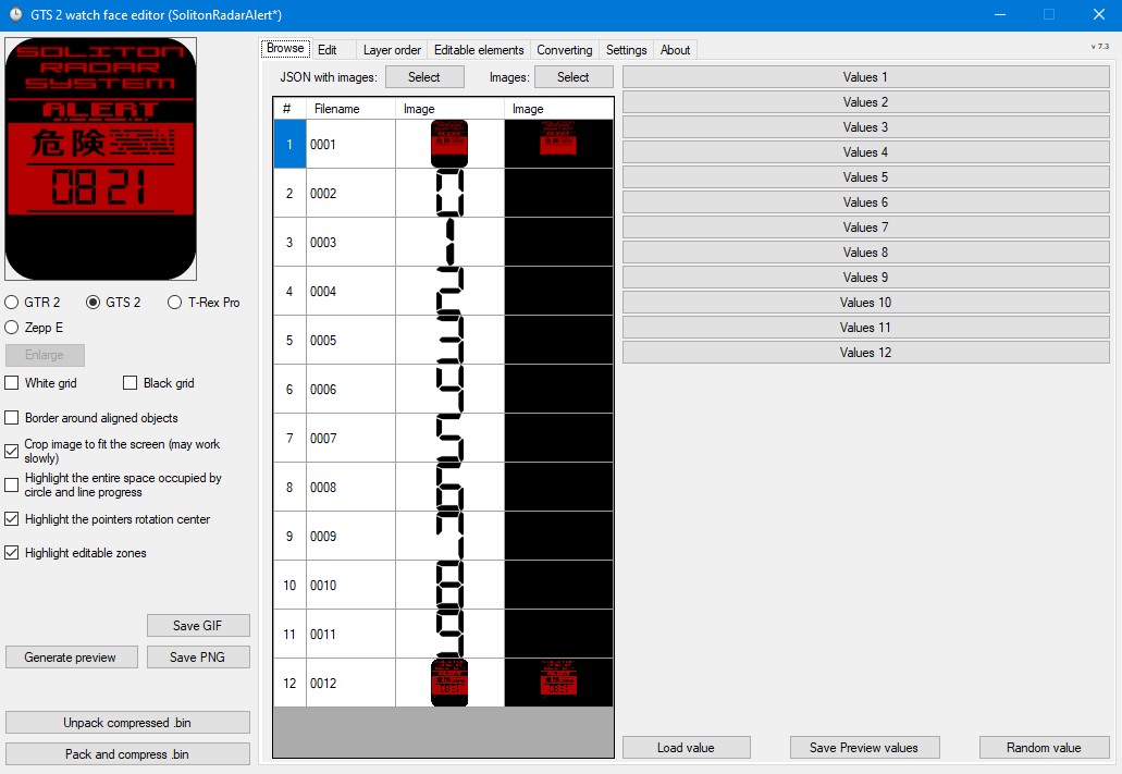

Hello and thanks for this program! I'm new to making watchfaces. I decompiled and edited a few to see how it works.
I am now working on a watchface from scratch to get the hang of it.
I only have a background image and a couple of numbers and it looks fine in the editor, but when I export it to my GTS2e the "preview" image that already has a static Time on it is used as background, meaning the actual Time display is overlayed on top. I must be doing something wrong, but I don't know what :( .
Below is a screenshot of the editor, a picture of how it looks on the GTS2e itself and the packed .bin is attached to this post.
Thanks in advance and may you all have a nice day :)

Posts: 2201
Been thanked: 2122 times
Evergreen777 wrote: 22 Nov 2022, 09:44
I attached a screenshot of the editor to this post, as well as a picture of how it looks on the GTS2e itself:
I think it those interested in helping you would be difficult to answer the question asked.
I suggest you attach a file of your work.
or the job's .json file

asoo Thanks, I'm going to add the packed .bin. What would be the most convenient way to add the .json? I cannot attach it to my post, the forum won't allow it.
Posts: 2201
Evergreen777 wrote: 22 Nov 2022, 15:42
@asoo Thanks, I'm going to add the packed .bin. What would be the most convenient way to add the .json? I cannot attach it to my post, the forum won't allow it.
If you can send a BIN file, that's enough.
json is already in BIN
But is the file you sent is the one that caused the problem as you stated?
Because from the picture that you have attached before, there are 12 image files.
But the BIN file you attached contains only 11 images.
Since I don't have GTR2, I can only verify the json file.
As far as looking at the json there shouldn't be any problem in the file you attached.
little introduction
if possible
I suggest that the main screen and preview files should be
0001 and 0002 respectively.

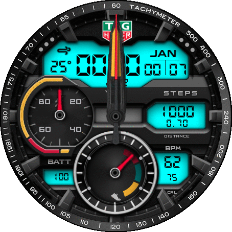

SashaCX75, firstly, congratulations on the beautiful work, intended for the various versions of the Amazfit gtr. I liked this watch face (image attached) on my gtr 47mm, and because it is sensational, and created by the brilliant me el-professor, I decided to use it on my gtr 2. Ok, I did the conversion using your program, but the analog step pointer, It didn't appear on the clock. Do you know what happened? Is there a way to resolve this? Thank you again, and success always!!
Posts: 2201
fertrema wrote: 11 Oct 2023, 23:08
If you use program".AmazFit_Watchface_Editor_(GTR47ToGTR2)" to convert GTR47 to GTR2
SashaCX75 has already stated that There may be some components not working.

Posts: 823
Joined: 26 Oct 2019, 15:18
Been thanked: 1036 times
Post by SashaCX75 »
@fertrema Converting watch faces uses undocumented features of watch faces and therefore may not work properly. The most reliable way is to make a new watch face for the desired model in the appropriate editor.
