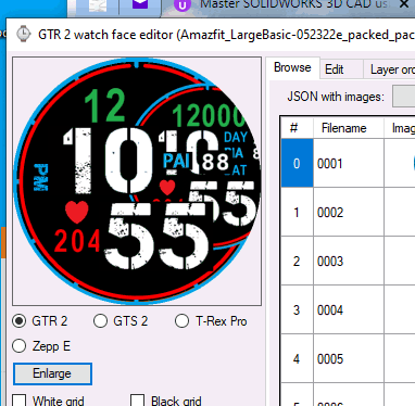

Post by Steve2fit »
I am running Version 7.3. I am not sure why I am getting double images when I do a Refresh Preview. I have no idea how to clean this up and it does get carried over to the watch.
This only appears when I do the Refresh Preview, no other time.
Any help would be appreciated.
Posts: 2201
Been thanked: 2122 times
Steve2fit wrote: 23 May 2022, 19:32
If you need help fixing the issue . I recommen you to attach the watchface you are having problems with, or at least .json of that work.
Just the picture that you show, it's hard to predict what that issue.

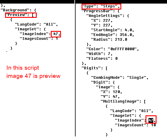

Posts: 2201
Steve2fit wrote: 24 May 2022, 12:43
Hi,
I have attached the file for you to review.
Your issue is steps image index start at 0047.png . I think that file is preview picture.
if steps show number 0 it will be show preview picture. so I think that's the problem.
