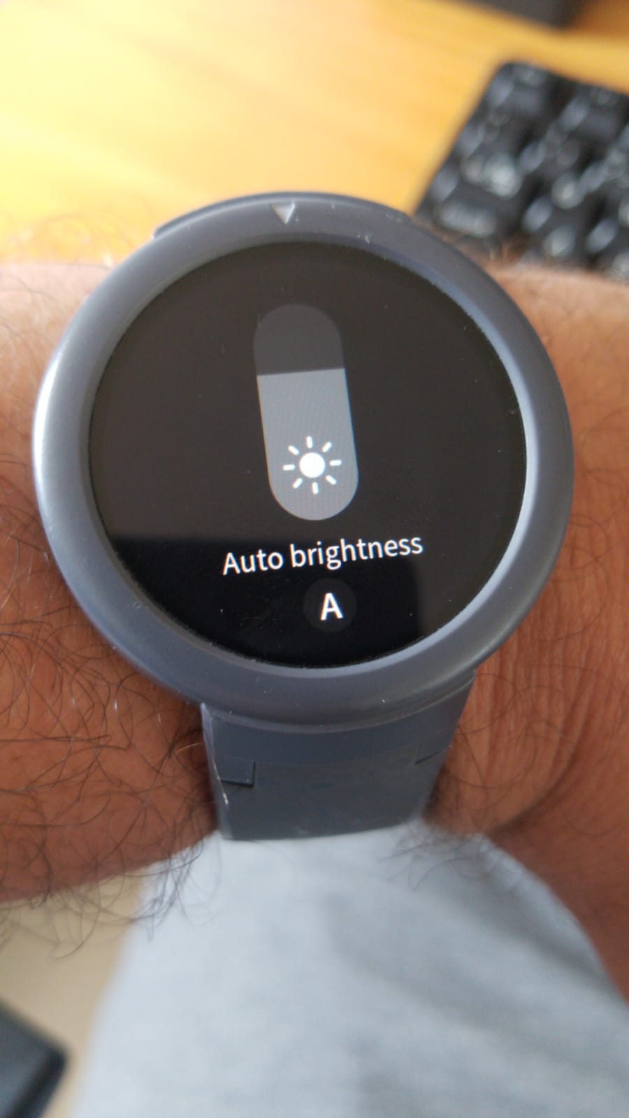

renatohennys
Повідомлень: 4
З нами з: 13 листопада 2020, 14:17
Звідки: brasil
Контактна інформація:
Повідомлення renatohennys »
Rogerio, i downgraded using the file that u attached here ( verge-lite-global-firmware 1.3.2.00.zip) and im using right now. When i downgrade to this firmware , about 2 min pass, my watch restart again.. so i realized that i aways used my device in full brightness screen setup.. and tried to low a litlle bit the brightnes. Since then, i do my exercises and the device is perfect ! 5 days since i did that ,and no reboot or shootdown! Im very happy! Ps.: im using only the notfy for amazfit 10.5.2 in my phone.

rogeriodeluca
Повідомлень: 10
З нами з: 02 листопада 2020, 14:47
Звідки: Campo Mourao
Повідомлення rogeriodeluca »
Hi there!
I never give up! Testing the actual firmware downloading with Mi Fit... Turned off auto bright, just like Renato did...
No reboot during training...
