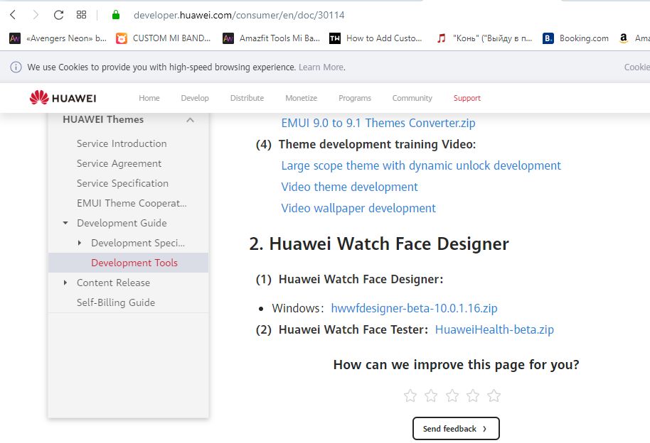

I use Honor Band 5 Analog watchface "Huawei Watch Face Designer" (You can download it on huawei developers page - see attachment). Unfortunately the analog watchface creation dialog is not listed in this software. We need to do it semi manual:

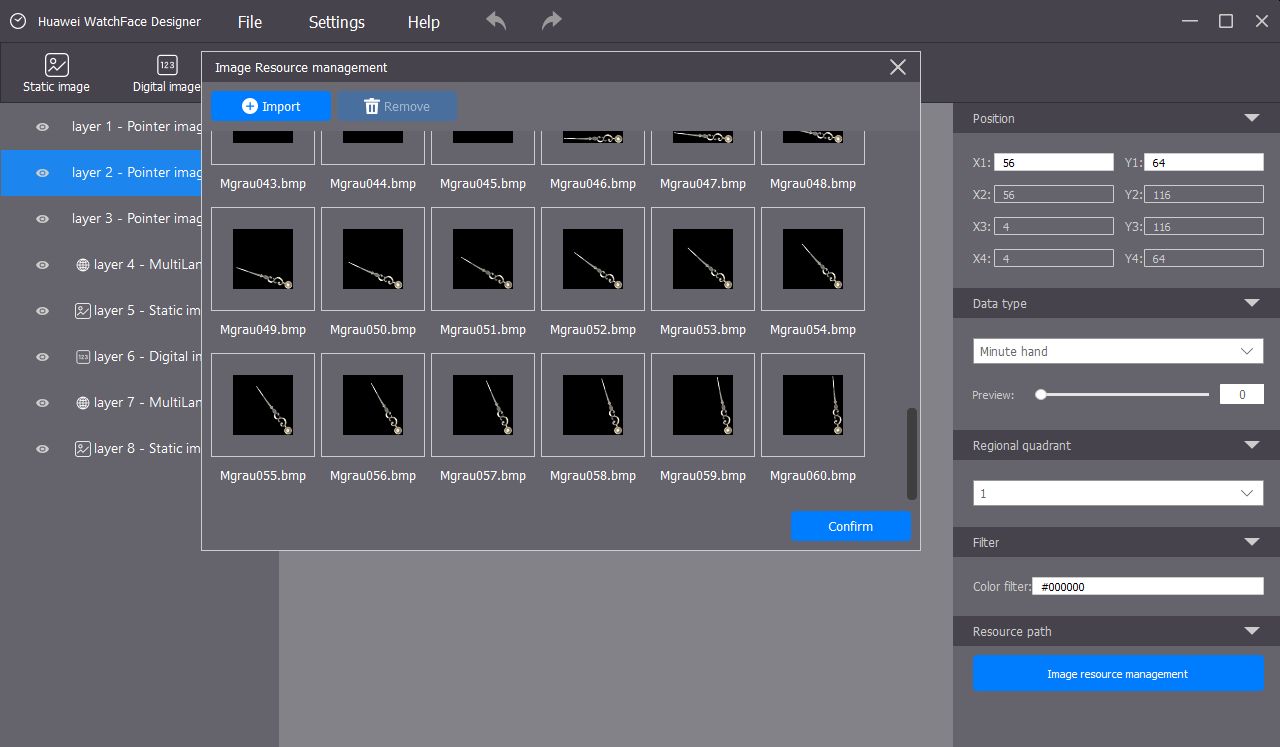

Some hints :
Maximum size of com.huawei.watchface file is just 600 kb (watchface will fail to upload to your Band). Save file size on each picture. Arrows picture divided into 4 quadrants. Each quadrant consists of 15 pictures(0-14;15-29;30-44; 45-59 h/m/s). Usually using Irfanview I create Vertical Arrow that starts in the middle of square picture. Than I fine rotate (keeping original image/canvas size) by +6 degrees untill make first 15 pictures. Than using batch conversion I trim all pictures to make it small as possible. Next I rotate these 15 picture by 90 degrees. The same procedure is applied for next to quadrants.
Use some geometry to find out the x and y coordinates for each quadrant.
Be sure your images are at least 24BPP color depth.
Have fun

hello,
can you explain this with pictures please
"Each quadrant consists of 15 pictures(0-14;15-29;30-44; 45-59 h/m/s). Usually using Irfanview I create Vertical Arrow that starts in the middle of square picture. Than I fine rotate (keeping original image/canvas size) by +6 degrees untill make first 15 pictures. Than using batch conversion I trim all pictures to make it small as possible. Next I rotate these 15 picture by 90 degrees. The same procedure is applied for next to quadrants.
form what i understand i need to make 60 pictures for every pointer !
so this means 180 pictures !!
am i right ?

You are wright. But I would say 15 pictures for each pricker, than Using Irfanview , you can rotate all 15 pictures by 90 degrees (Batch convert).
Also be sure to save space even small bmps are really spacy. "Com.huawei.watchface" file should not accede 600 kb after export.
