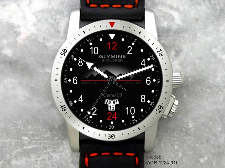

Hi all,
I am trying to see if it is possible to encode this type of watch face on the GTR. Does the API even allow to specify 24hr analog hand (15deg per hour) or is the 12hr assumption hard coded ? Also, will it allow the date to change when the hour hand is at the bottom ? (24 at the bottom).
GlymineCamp23 12-12.jpg (80.92 KiB) Viewed 2517 times

Post by kampanita »
It's not posible.
It could be done with images instead of numbers, but then it will need so many images and the package should become so bigger that can not be installed at device.
It would need analog hands for minutes and seconds and twelve different "complete" images for the hour hands << this forces .bin file to be so big that can not be installed.

Post by ThomasAn. »
kampanita wrote: 22 Jan 2020, 12:59
It's not posible.
I suspected as much after looking at some sample bin files. Good thing I asked, before investing too much time.
Thank you so much for your comments !
