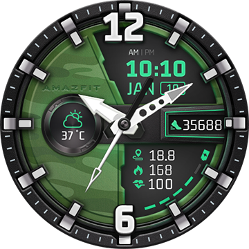

We just got update for GTR with some new watch faces in Amazfit app. So...watch faces are now supporting weather. I tried to unpuck bin file via tool, but got error.
C:\Users\vko\Desktop\AmazTool All 0.1.0.11>WatchFace.exe -size360 332.bin
Processing file '332.bin'
Opening watch face '332.bin'
Reading parameters...
Parsing parameters...
Parameter does not exists (WatchFace.Parser.WatchFaceVerge)
System.NullReferenceException: Object reference not set to an instance of an object.
   at WatchFace.Parser.Utils.ParametersConverter.Parse[T](List`1 descriptor, String path) in E:\Works\Escorp Dynamics\Lab\Exomode\amazfitutils\WatchFace.Parser\Utils\ParametersConverter.cs:line 89
   at WatchFace.Program.ParseResources(Reader reader) in E:\Works\Escorp Dynamics\Lab\Exomode\amazfitutils\WatchFace\Program.cs:line 396
Any chance you could research bin file and update tool?
332.bin
New face with weather
(551.49 KiB) Downloaded 462 times
