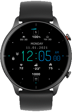

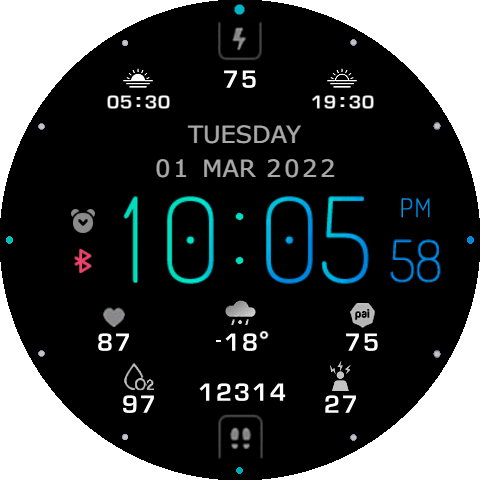

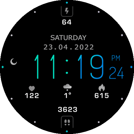

Good morning to community and to creators and have a nice weekend. Can anyone from creators convert this watchface for GTR2 of course without animation because GTR2 don't support . Make it same like GTR 47mm version but add sunrise and sunset time like GTR3 version and 24h icon. If it's possible add analog seconds at perimeter. I already ask wax for permission. Thank you guys for all. A big thanks to wax for this amazing watchface.
https://amazfitwatchfaces.com/gtr/view/27462
https://amazfitwatchfaces.com/gtr/view/27344
