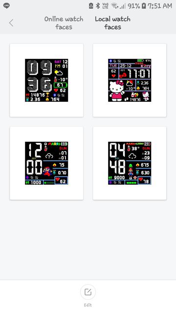

You can use "watch skin local" (Local watch Face) in Mi Fit to update or change your watch face.
But you must to edit some bytes in the .BIN file In order to make that .bin file can be displayed in "watch skin local"
How to HEX your .BIN to use in "watch skin local" of Mi Fit
1. open your .BIN with HexEdit ( https://www.dropbox.com/s/hmqdynh8dl0lj ... t.zip?dl=0 )
2. on bytes 17 to 24 edit FF FF FF FF FF FF FF FF to 0F 00 EE 00 00 00 39 60 and save 3. Now your .BIN can use in "watch skin local" of Mi Fit
How to use "watch skin local" ( Local watch Face )
1. Folder of "watch skin local" is /storage/emulated/0/Android/data/com.xiaomi.hm.health/files/watch_skin_local/
2. make new folder in "watch skin local" ( one folder for one watch face )
3. Copy modified youreWatchface.BIN and yourWatchface.jpg or png or gif in your new folder
4. Now open Mi fit and go to "Local watch Face" you can see your Watcface

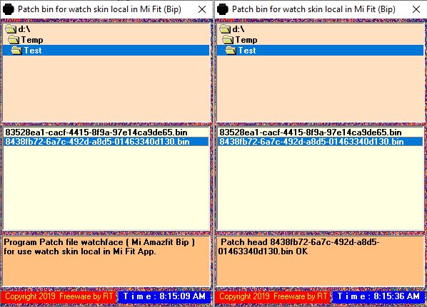

I write a small program for patch bytes 17- 24 of BIN with VB . ( for Windows)
The program will work by patch FF FF FF FF FF FF FF FF to 0F 00 EE 00 00 00 39 60
use by Double click on file.BIN in screen 2 If you can't use hex, you can try using my program to patch BIN
viewtopic.php?f=6&t=560

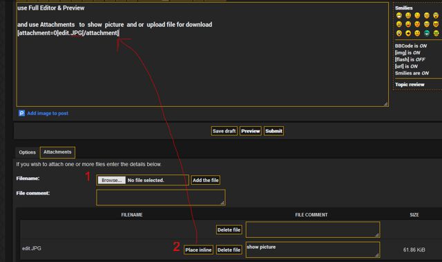

Just a question.
How do you add images in a reply on this site? In my case the amazfitwatchfaces stop any image I want to add within my reply. Thanks.
use Full Editor & Preview and use Attachments to show picture and or upload file for downloadasadulhuq 写了: 13 2月 2019, 13:56Just a question.
romstemp 写了: 13 2月 2019, 01:29I write a small program for patch bytes 17- 24 of BIN with VB . ( for Windows)
bip-patch-bin.zip
