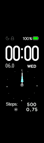

Hello, I need help with creating / converting my favorite watch face from Mi band 4 to MI band 6. I try to make it with the Watch editor, but unfortunately the result are not so good - second are not working and ect.
Can some one transfer this face from 4 to 6 Mi band and add distance in km at the bottom below the steps?

Post by Jackall Digital »
Hey deemmo,
I might do it if I find some free time. Since I don't have MB6 it would be up to you to test it (what I see in the generated preview may not work in the actual MB).
As for the design, did you want the elements repositioned to fit more in line with the actual MB6 or would a centered position work for you? When it comes to the distance, what exactly did you have in mind? Since there is no way to tell what font was used - the texts "distance", "km" and the dot delimiter "." would have a diferent font. Also, all images would be left as in the original, so no upscaling would be done.
Also, I don't know if analog seconds work in MB6, it's something that you should test by installing other watchfaces that have analog seconds. This is also the best way to learn how to make watchfaces, by using other working examples.
deemmo
I've done the conversion of the mb 4 watchface to mb6 using the graphic that was available. Try it out to see if it works and make other changes as you see fit.
Analog mb4 to mb6_packed.bin
(225.64 KiB) Downloaded 189 times
Analog mb4 to mb6_packed_animated.gif (93.22 KiB) Viewed 5056 times

Post by deemmo »
Hello Jackall Digital,
Thank you so much for your support.
I have uploaded the Face and everything is fine, only the analog clock has no hands.
I have tested with other analog faces and they are working - also the clock hands for seconds work.
Again thank you for the help - can this issue with the clock hands be solved?
Hey deemmo
of course the issue can be solved. If it's working in other mb6 watchfaces it can work in this one. Now I don't know which watch face you tested but you can simply look at both json files to compare the code and figure out what is not correct in the one I converted.
Or you can point me to the watchface you used to compare and I'll take a quick look myself.

Post by deemmo »
Thus is the skin that I tested and the seconds hand are working.
f5bd5543-1ca1-4984-aea4-67abd9a09818.bin
Hey deemmo
I took a quick look and there were only 2 differences that I could see. Let me know which version works, if it works.
As for the differences, in V2 I've added a blank delimiter to the digital time section. In V3 in addition to the delimiter I've also changed the analog clock hands shape - as it seems the watchface you linked uses 4 points to make an analog watch hand, but in the original mb4 watch face, there were 5 points for the hours and minutes.
If this still doesn't work then I have no idea.
Analog mb4 to mb6 v3_packed.bin
V3 - clock hands made with 4 points
(225.62 KiB) Downloaded 155 times
Analog mb4 to mb6 v2_packed.bin
V2 - added blank time delimiter
(225.65 KiB) Downloaded 194 times
