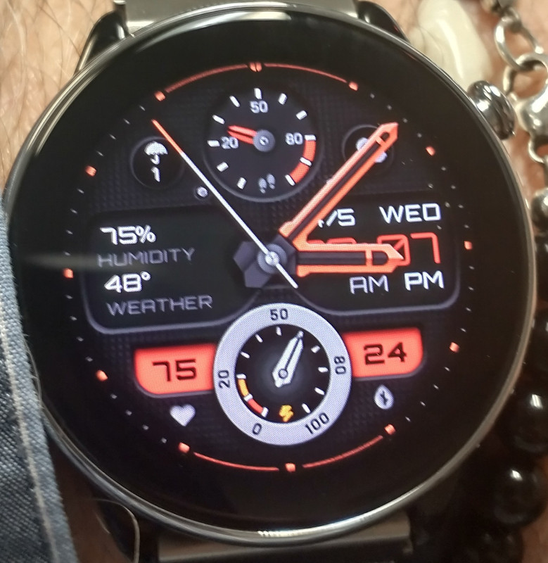

I tried loading the Falcon watch face. It loaded but it was unreadable. Do you know of any designers that are working on the new GTR Mini yet?

I have try several falcon watchface on my gtr mini none of them can use, it unreadable like this

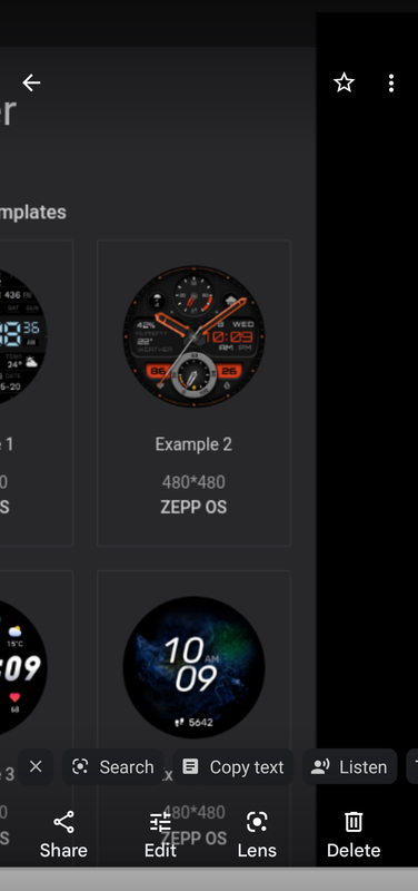

I try making a watchface using watchface.zepp.com by start from example2 template, then scale it to 416x416 and upload to zepp app via developper modes, the watchface is work fine
Don't know why falcon watch face not work on gtr mini

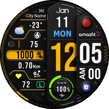

- Posts: 2206
- Has thanked: 421 times
- Been thanked: 2128 times
GTRmini users please help to test this watch face.
This watch face is made for Test converting the image to the format of GTRmini.
Anyone who has tested it, please inform the result.
thank you very much
https://amazfitwatchfaces.com/gtr/view/32946
This watchface convert from GTR3 Version
https://amazfitwatchfaces.com/gtr/view/32137
in GTR3 Version tested it work normally
thank you very much

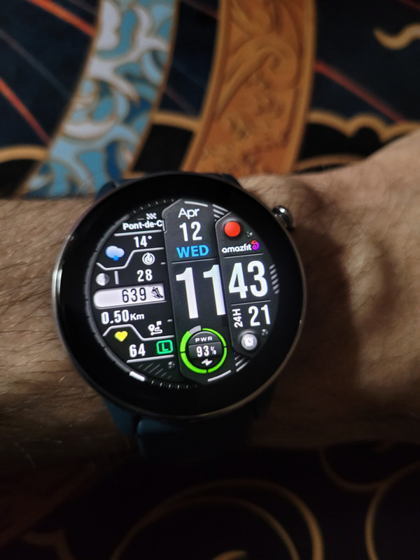

kmi
- Posts: 2
- Joined: 04 Apr 2023, 19:14
- Location: France
- Has thanked: 1 time
- Been thanked: 3 times
it works, here:asoo wrote: 12 Apr 2023, 04:54Spoiler
thank you very muchG317_GTRmini.zipSpoiler
