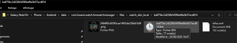

Hi^^ got the same problem with my S8+ [Android 9 ] Exynos and my Note 10+ [Android 10] Snapdragon.
When i Try to download a face, the face is 77Kb instead of the right size.
So... when you I try to sync it.... It fails.
The workaround is to manually download the file on amazfitwatchfaces.com and manually replace it
On a computer the size is good, on an android browser [ Chrome ] the size is also ok.
The size is wrong only in the Android Apk.

Lordalpine ha scritto: 20 giu 2020, 11:56
What version of the application do you have ?

Hi^^ Osmat
Note 10+ [ Android 10 ]
Amazfit watchface App : Version 1.5 // Version 1.5 beta [ I tried Both on google play ]
Amazfit : Version 4.4.1-play
S8+ [ Android 9 ]
Amazfit : Version 3.7.0-play
It is so weird because, the problem is only with new watchface uploaded
The last one that work for me created by myself is the Apollo of
Uploaded: 07.06.2020 22:43
Updated: 08.06.2020 23:52
If I try to download and sync a face created the 12 and 13 of june it fails, I made one last week uploaded it here and tried to sync and it failed
So I have removed it thinking there was a problem on the face [ and didn't want to make problem to other users ]
I use mainly my own face on my watch... but seeing your message I tried face from other person, popular or not and the result is simple for me
If it's a fresh face, the size of the file is 77B [ It's not KB it's B... ] [ from me or other users ]
If the face is an older one like the A P O L L O 11 [ so before 12 june, the size is Ok and It syncs successfully ]
To try a face I like a lot : The T a g 0 2 Gold from Jubial [ Initial work from Maikeldevil ] mainly because the face is in Portuguese....
It Syncs succefully..... Uploaded: 16.04.2020 21:25
I have only Samsung Phone @ house.
Tomorrow I can test on my Dad's phone a Redmi note 9S [Android 10] with a GTR lite 47mm if it works [ It can affect only samsung Phone after all ] because Tomorrow in France It's "fathers Day" [ His gift is The GTR lite ]
Trying this is free so I will try^^

Lordalpine ha scritto: 20 giu 2020, 14:25
Hi^^ Osmat
What method is installed on the watch, replacement?

Messaggio da Lordalpine »
Stas ha scritto: 20 giu 2020, 19:07
Hi^^ Yes File Swap on the Phone... [Copy to Watch_skin_local ]
File is downloaded by the App, when you check the size of file, it's only 77B.

Messaggio da Stas »
Thanks for the reply, tomorrow there will be a version with a fix in beta
Stas ha scritto: 20 giu 2020, 20:41
Hi Stas, problem is solved for me... the new beta version works.
The problem with a 77B file is gone.
The download size is OK
The Face sync is OK
