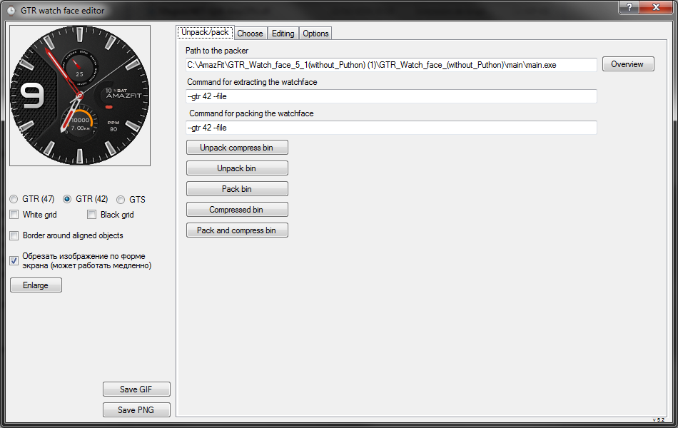

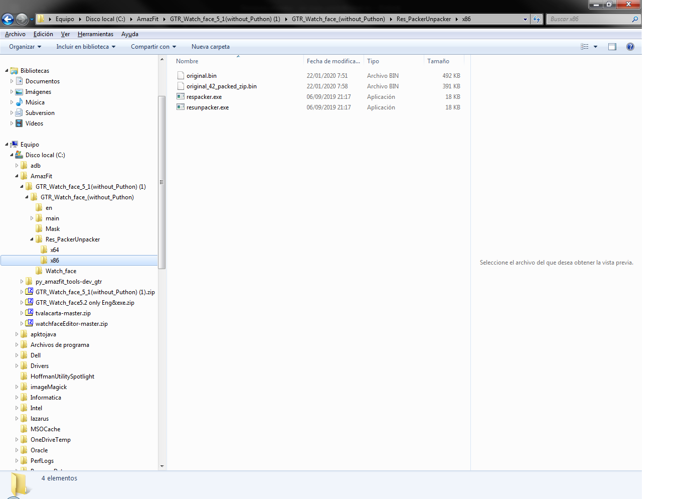

You need SaShaCX75's app for doing it ( Watchface_GTR )
ResPacker << used to compress the bin
ResUnpacker << used to uncompress the bin
These are two diferent things uncompress and unpack
* uncompress ( resunpacker ) decompresses the bin and gets another bin
* unpack extracts all the files at the bin ( .png, .json )
App that helps to compress - uncompress - pack - unpack
Respacker and resunpacker at SashaCX75's app

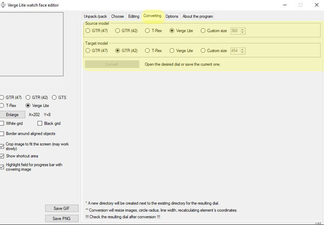

Posts: 2209
Has thanked: 429 times
Been thanked: 2132 times
You can try this ( viewtopic.php?p=5109#p5109)
GTR_WatchFace editor for Windows by SashaCX75
Version 8.0
- Added the ability to convert dials between different watch models (GTR47,42/ T-Rex / Verge Lite).
