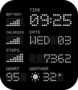

I'm making an edit of my watchface "Dotted Clock" and it's gonna have different colors for the whole wathface (little spoiler haha), but having a problem to show the hrm and weather temp correctly.
I've had made cuts in the bg to fit the imgs numbers showing the data for hrm and temp (the numbers individually are 35x47) so for the hrm the cut is 105x47 (so it fits when hrm is over 100) and for the weather temp is 140x47 (considering minus sign, 2 digits for numbers and the degree sign). The exact problem is that when the number width is less than the cut out the color can get through the empty space next to the number and I wanna find a workaround to fix this.
Already have the images to "cover" the empty spaces depending on the number of digits the hrm and weather temp are using but haven't find a way to get the width size of the current element of the text. I've managed to use getProperty(hmUI.prop.W) for the weathertemp but I get the size of the whole possible thing and not whats showed in the moment. All this might sound like a mess but hopefully someone can understand and help me. Also thank you before hand if you made it reading until this point :D

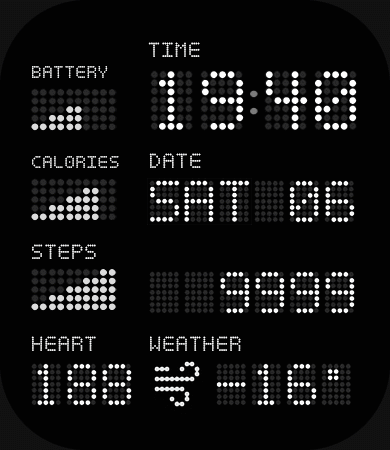

If I understand your explanation correctly, you want to create a color-changing dial. You'll use the transparent image property to create a dial that changes all the text colors. However, you're having trouble with the uneven image sizes, which can lead to uncovered spaces.
In this section, I used the method of changing the image file of that element to get the desired color.
Therefore, you don't have to worry about the uneven size and gaps in the background color coverage.
I've included an example of my design. I hope it's helpful.
To change the color, click on the top of the screen.
When you click on the color, the screen will turn off. Click on the screen again to turn it back on and refresh the color changes.
Sample :

Use the sensor to obtain the value of the displayed parameter (e.g., heart rate). Knowing the value, you can find out how many digits it has and calculate its size.

@asoo tysm for the help, managed to do it that way and now it's posted
@SashaCX75 tried that way, but as im pretty noob with js gave up and wanted an easier way (especially when i had to edit the images needed for all the colors i added)... could you give details about how to do it tho? i looked into zepp docs and i saw i could catch the data using listeners, but didnt understand it that well (especially for the weather)
