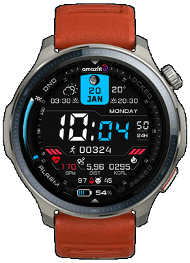

https://amazfitwatchfaces.com/gtr/view/22950
Only yellow can be installed on balance2
Blue and Red cannot be installed
Error show parsing failure
Hope someone can help

It is recommended that if possible, please send for information
1. Did you install it through the zepp app using developer mode or with another program
2. Can you capture the error that occurred?
Note :
When generating QR code, it is recommended to refresh before generating the next one.
As far as I tested, the blue and red QR Codes are installed normally. But I tested on Balance.
( install through the App zepp )
This is the QR code of the blue watchface that I make a new pack. Can you try to install it?
Click for Show QR-CODE

The QR code installation in the original watch face link will display the following error
The QR code you provided can be successfully installed in Balance2
thank you very much!
Also tried If I switch the language of the zepp app to English
Then the original link can also be installed (test in red ver.)
Seems like a problem with the installation definitions?
Zepp in Chinese language only yellow can be installed anyway

In this case that you report I and not sure ( I can not test it )
airdmo wrote: 23 May 2025, 11:20
Thank you for tested by QR
That is my test pack with platforms Balance2
"platforms": [
"name": "Amazfit Balance2",
"deviceSource": 9568512
"deviceSource": 9568513
"deviceSource": 9568515
So in my personal opinion, I think the Balance watchface should work with the Balance2.
