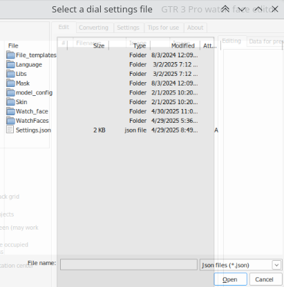

The editor uses standard file selection dialogs, so it is strange that they cause problems.
Is this problem only with the *.zip file selection dialog or with all dialogs?
If you open files not through a dialog but in the context menu of the file choose to open it with the editor (I don't know how it looks like in Linux) does it work?

I think it could be related to the preset file filter. .json files are shown when opening a project.

If you are interested in this, I can try to see what the difference in filters is and make a test version. At least add all files to the selection. But it will be necessary for you to check whether this variant works or not.

The problem was caused by extra spaces in the filter. On Windows it works but Linux seems to be more sensitive to the format of the caption in the filter.

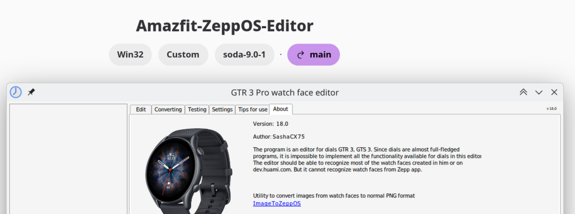

Step-by-step guide: Running the Amazfit Watch Face Editor (ZeppOS) on Fedora / Linux with Bottles
I am currently using Fedora 44 KDE Plasma. The older Wine / winetricks guide still works in principle, but for me the easiest current method is using Bottles as a Flatpak.
This is the setup that worked for me.
Tested bottle configuration
  • Bottles package: Flatpak
  • Bottle name: Amazfit-ZeppOS-Editor
  • Environment tested: Application
  • Architecture: win32 / 32-bit
  • Windows version: win11
  • Runner: soda-9.0-1
  • Installed dependencies: dotnet40, dotnet48
Important note about the architecture
I tested the editor with the Application environment and it worked for me.
My working bottle is win32 / 32-bit. I am not sure whether Bottles always creates Application bottles as 32-bit by default, so if Bottles gives you an architecture option, choose win32 / 32-bit.

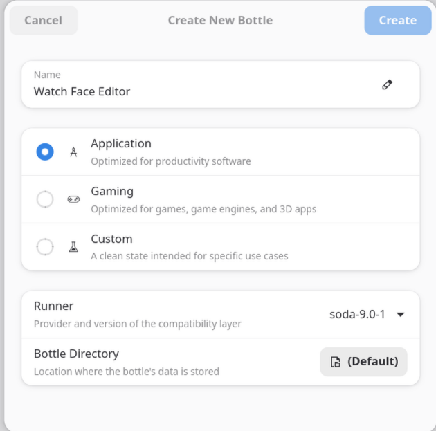

2. Create a new bottle
Create a new bottle.
Recommended settings:
  • Environment: Application
  • Architecture: win32 / 32-bit, if Bottles asks for the architecture
  • Runner: The default Soda runner should be fine. My working bottle uses soda-9.0-1.
I would recommend using a fresh separate bottle only for the Amazfit / ZeppOS editor.

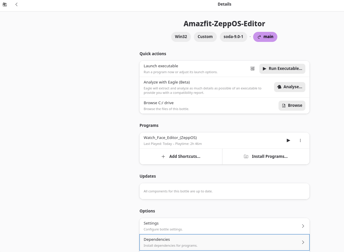

3. Install the required .NET dependencies
Open the bottle and go to:
Codice: Seleziona tutto
Dependencies
Search for and install:
dotnet40
dotnet48
I installed dotnet40 first and then dotnet48.
Wait until both dependency installations are finished. Do not interrupt the installers.

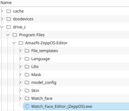

5. Put the editor inside the bottle
In Bottles, open the bottle and choose:
Browse C:/ drive
Then copy the complete extracted editor folder into the bottle's C: drive.
For example, I used:
C:\Program Files\Amazfit-ZeppOS-Editor
The executable should then be located at something like:
C:\Program Files\Amazfit-ZeppOS-Editor\Watch_Face_Editor_(ZeppOS).exe
This is not necessarily the only possible location, but it worked for me and keeps all program files together.

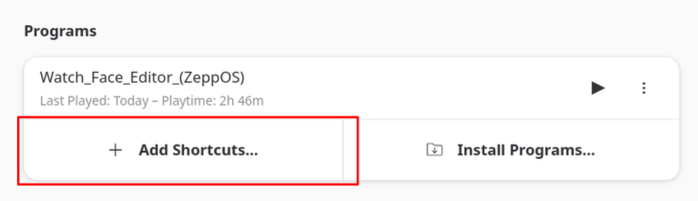

6. Add the executable as a shortcut
In the bottle, go to the Programs section.
Click:
Add Shortcuts...
Select the editor executable. In my setup it is here:
After that, the editor should appear in the Programs list.
7. Start the editor
Launch it from the Programs list inside Bottles.
If it starts correctly, you can also create a desktop/menu shortcut from Bottles later.
