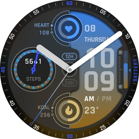

Hey,
I wanted to edit another watchface/watchfaces, but I'm struggling with unpacking it.
Sasha's editor doesn't work (says unrecognized structure of watchface),
I tried unpacking it via Zmake program I found on net, but seems like colors are changed a bit, also I can't open json file or bin to see positions for everything for at least recreating it in Sasha's editor because it shows null values
These are watchfaces I'd like to unpack and edit:
https://amazfitwatchfaces.com/gtr/view/39798
https://amazfitwatchfaces.com/gtr/view/36289

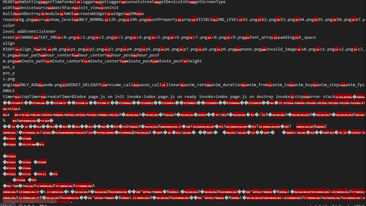

The json file opens fine. But there is nothing useful in it. The bin files cannot be opened. That's why you can't edit this watch face.
The only thing you can do is unpack images from it.

The json file is just a manifest. It has never had any widget parameters in it. All widgets are in the js file. But sometimes the js file is encoded in bin and then you can't do anything with it.
I don't know for zmake. In my editor if you select the correct model then the images are extracted. Even if you can't recognise the watch face code, the images will still be extracted to the folder.
You can also just copy the watch face images as from the archive and then convert them with this utility
https://www.dropbox.com/scl/fi/nzw0e873 ... bvlpf&dl=0

I see, so best way is to just resize preview and make it myself i guess,
One more question, how do they make numbers following pointer or progress bar? Is it some coding or it can be done somehow in your program? You can see it here, with steps, heartrate or battery levels.
Also what's about sleep? I'm blind or I don't see Sleep element :/ https://amazfitwatchfaces.com/gtr/view/39798
