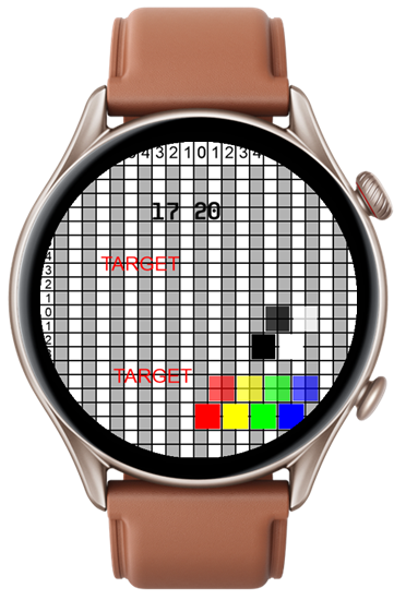

Posts: 2209
Has thanked: 429 times
Been thanked: 2132 times
Sharpshot90 wrote: 23 Sep 2023, 21:41
The watch faces load up okay for me using the gtr3pro category but the aod has a green tint which is slightly annoying. Any one else have the same problem or found a solution to that?
It's strange that AOD shows a greenish tint.
As far as I test that dial on gtr3, the AOD is black.
It is possible that the "Balance" has slightly different color rendering specifications than the GTR in AOD.
Could you please test this dial on "balance"?
This dial is a color test dial, to test whether it displays correctly on "balance" or not.
Please test on normal and AOD
balance_color.zip
(158.87 KiB) Downloaded 454 times
viewtopic.php?p=16398#p16398

Sharpshot90
Joined: 28 Aug 2023, 12:06
Location: Florida
Post by Sharpshot90 »
Xphyle1971 wrote: 24 Sep 2023, 11:46
What method are you using to load the watch faces onto your Balance?
I use the amazfaces app and it’s able to detect the amazfit balance. Also the color test watch face doesn’t seem to have a greenish tint on the aod display.
Posts: 827
Joined: 26 Oct 2019, 15:18
Has thanked: 14 times
Been thanked: 1043 times
Post by SashaCX75 »
@Sharpshot90
Here are the test dials to check if the colours are correct. One is created in my editor, the other in the official editor. See how they are displayed on AOD.
device.zip
(68.54 KiB) Downloaded 441 times
Test-Balance.zip
(34.51 KiB) Downloaded 440 times
