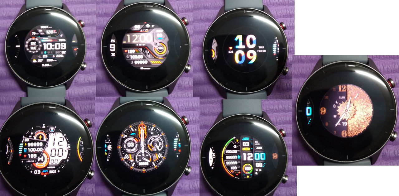

I don't know why is not work with you , but it work for me now i have 7 watchface in my watch and it's work normal
- Do no GTR2e
- use zepp to link
