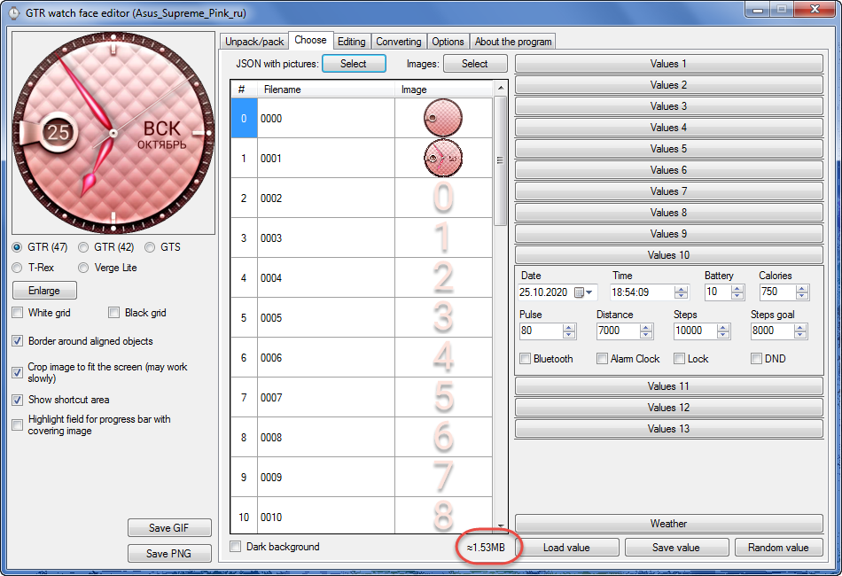

Post by SashaCX75 »
Screenshot
Version 10.0
List of changes
Updated translation.
v 9.0
v 8.5
Fixed work with Verge Lite
v 8.4
Fixed Italian translation.
Added Chinese manual.
v 8.3
Bugs fixed.
Added a manual in English.
v 8.2
v 8.1
v 8.0
v 7.1
Italian language added.
Minor fixes.
v 7.0
Added animation support
Verge Lite Support Added
v 6.1
Added support for T-Rex.
v 6.0
Added support for shortcuts.
v 5.2
v 5.1
Updated bin file packer.
Added display of the year.
English support added.
