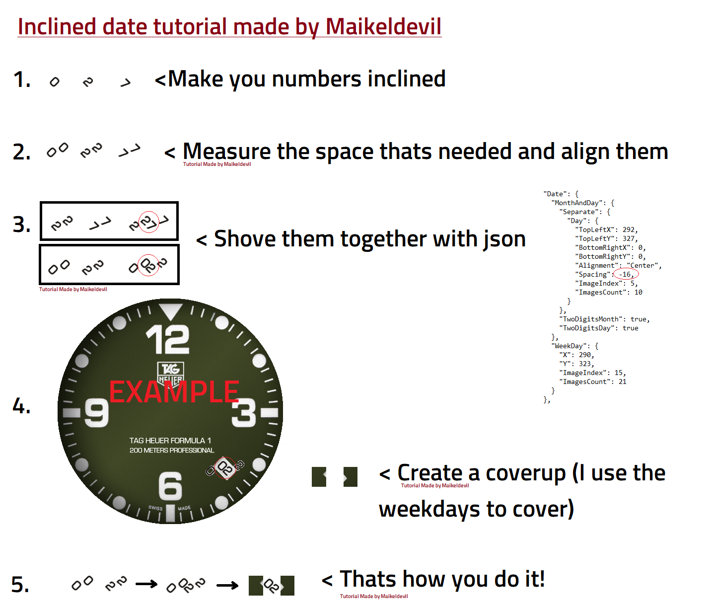

Due many request about how i make inclined dates, here the secret:
Goodluck! A thank you in the post is welcome!

Thank you so much, sorry that we can’t do the same for displaying the date vertically. Like:
3
1
or
0
1
or
2
2

I think its possible with the same way.. just make numbers vertical instead of inclined:-)
I updated the thread with an example of vertical dates! Example format is day: 21!
Dont do it like the example it should be done the other way around XD but you get my point!

Yes, I already understood the principle. It is necessary to make a set of numbers:
 0  1  2
0  1  2
The result will be:
 02
02
Thanks!

Si :-) look forward to your creations!
