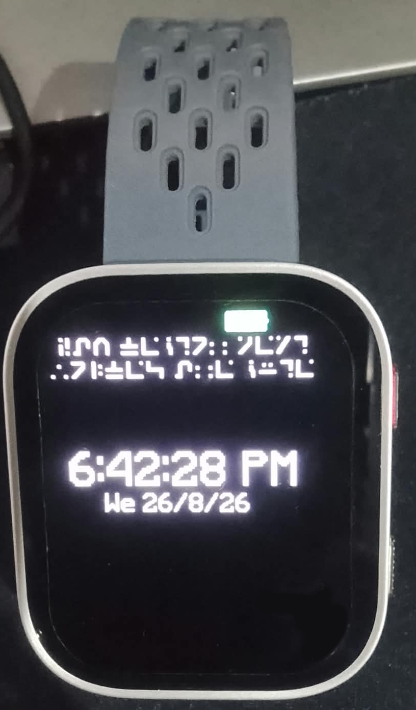

I'm not sure either. From the file you attached, I unpacked and packed it using the SashaCX75' editor, creating two files: a zip and a zpk.
Then, I tried creating a QR code from the .zpk file, and it installed normally.
Here's a screenshot of your watchface installation test created with the SashaCX75' editor on BipMAX.
