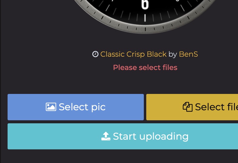

1. How do I upload the face to Amazfit Watch Faces with multiple images?
  • I can only select 1 image
  • I can't select the .zab file
You can’t upload multiple preview images directly, but you can use a GIF as a single animated preview. Additionally, you can embed multiple static images into the description using BBCode like this:
Código: Selecionar todos
[img]https://link.to/image.jpg[/img]
— just upload your images to any image hosting service first.

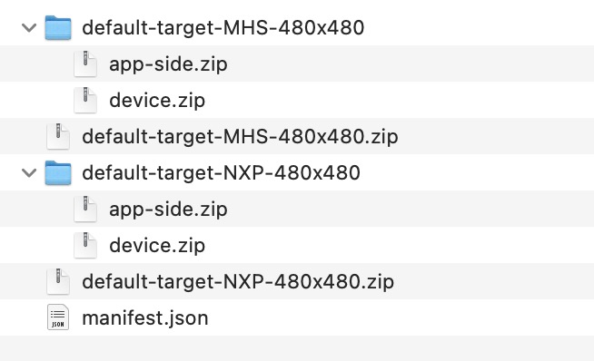

OK but the file which downloads using 'Export the watch face package' is definitely a .zab file - see attached...
Imagem
If I rename it to a zip file and extract it, I see two .zpk files. If I rename those to zip and extract, I see the device.zip files but which one do I upload?
Imagem
the device file inside 'default-target-MHS-480x480' or 'default-target-NXP-480x480' ?

Mensagem por GIK-Team »
BenS escreveu: 24 Jun 2025, 17:32
To answer this properly, you’ll need to examine both folders — default-target-MHS-480x480 and default-target-NXP-480x480. There’s a chance the .zip files inside are identical or very similar, but that’s not guaranteed.
Here’s what you can do:
1. Extract the device.zip files from both folders.
2. Inspect the contents.
3. If they’re identical, it doesn’t matter which one you use.
4. If they differ, it’s best to test them on the actual device or check in Zepp which target matches your specific model.
Without this comparison, it’s impossible to give a definitive answer.
